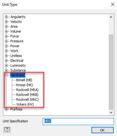

Hardness
Hardness is a brand new unit type added for this Inventor release. This allows hardness to be specified in the Finish command, but can also be used on it's own. The following types are available in the Parameters dialog:
  • Brinell (HB)
  • Knoop (HK)
  • Rockwell (HRA)
  • Rockwell (HRB)
  • Rockwell (HRC)
  • Vickers (HV)

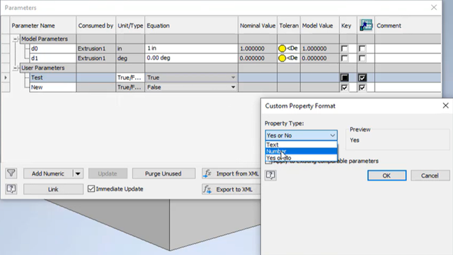

Export Boolean Parameter to a Custom iProperty
It is now possible to export both text and Boolean (true/false) values from the Parameters dialog to custom iProperties. These can then be retrieved for example in the drawing environment or 3D annotations. Text and Boolean parameters can also be exported when using the Derive function.
