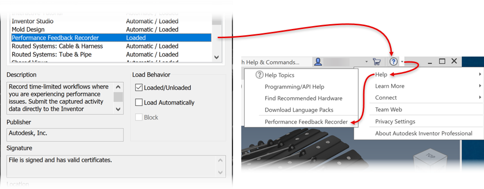

Performance Feedback Recorder (Add-in)
This new add-in is designed to assist in determining potential performance issues. Access to the tool is managed through the Add-in Manager. Once loaded, click the Help button
Help
Performance Feedback Recorder and follow the prompts. After recording your feedback, you are presented with a series of panels where you can provide information about your experience.
For more information, see To Use the Performance Feedback Recorder.
