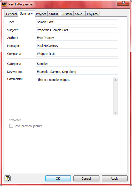

Autodesk Inventor has a set of properties associated with every document. The properties for a file can be viewed and set from inside Autodesk Inventor using the "File | Properties" command. The dialog displayed for this command is shown below. You can also access the properties using Windows Explorer by right-clicking on the file and selecting the "Properties" option. Autodesk Inventor's Design Assistant also provides access to document properties. You also have full access to the property information using the API.
Properties dialog

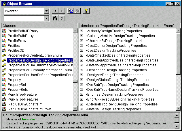

Using the internal name to obtain a specific property set is done in the same way, but first you need to know what the internal name is. The internal names for the Autodesk Inventor-created property sets are listed above. You can also find the internal names using the Object Browser. If you select the enumerator for the property set you're interested in, the internal name is displayed as part of the description at the bottom of the browser as shown below.
Object Browser
