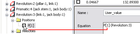

Note: You can add a variable by clicking the box to the left of the variable in the Output Grapher browser.
The software checks the name and equation in real time, but calculates curves only after the simulation stops. After validating the name and equation, the software places the new variable in the User variables folder. You can use it for all processing, including the creation of a new curve.
