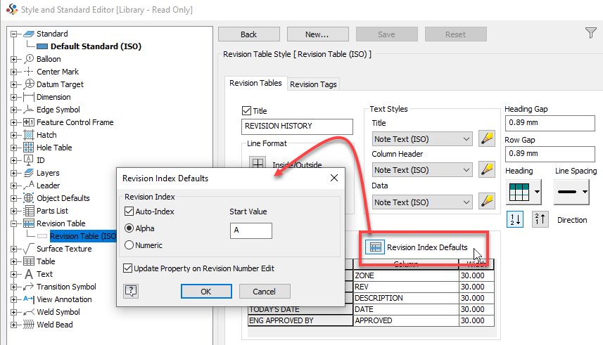

Revision Index Settings for Revision Tables
It is now possible to specify default numbering (alpha or numeric) from within a drawing template instead of via the revision table itself. A new "Revision Index Defaults" option has been added to the "Style and Standard Editor" for Revision Tables.
For more information, see Style and Standard Editor – Revision Table Style Reference, Revision Table Reference.

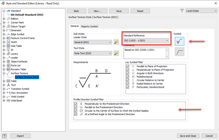

Surface Texture
You now can define Surface Texture Symbols based on the ISO 21920-1 standard.

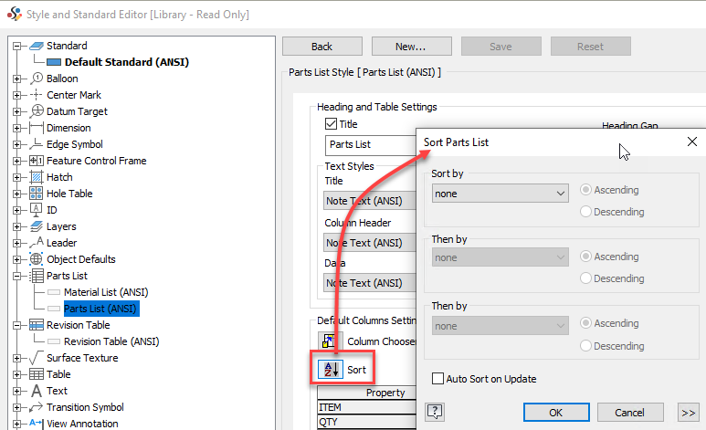

Add the Sort Parts List Option
You are now able to specify the sort order of items in the Bill of Materials (BOM) for parts lists directly in the Styles Editor using the newly added "Sort" option.
For more information, see Style and Standard Editor – Parts List Style Reference.
