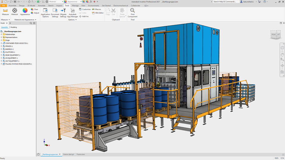

Inventor customers are constantly pushing the software with larger and more complex designs. To help our customers, we are continually looking for ways to improve Inventor performance. In Inventor 2021, you will experience improved performance in the following workflows:
Image courtesy of Feige Filling GmbH
  • Inventor responds faster when selecting many components at the same time using windows selection or component filtering.
  • Visibility status changes are faster using select or saved views.
  • Performance has been improved when inserting sub-assemblies.
  • Experience quicker visibility changes, when flipping the visibility of components directly or using saved views.

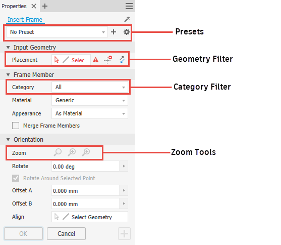

Frame Generator
Numerous productivity enhancements were made to frame generator for this release - including file naming, new category filter, editing capabilities, and more.

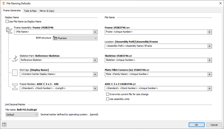

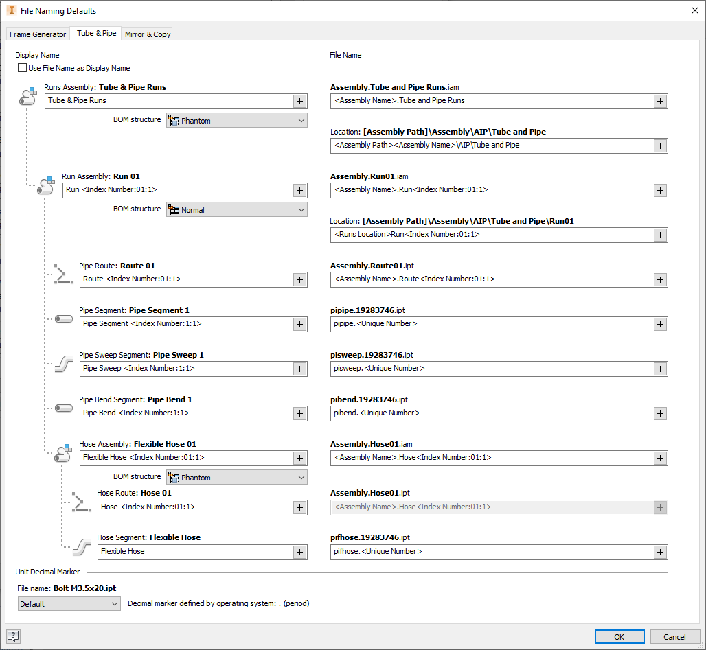

  • We have continued to make improvements to the file naming dialog, enabling you more detailed control of your naming schemes for frame generator components. A new option lets you set the file name of the component to be the same as the display name in the browser.
  • When creating frames, a new Category filter enables you to streamline your selection, and Presets help you save your most frequently used frame settings to use again later.
  • Geometry can now be filtered from the property panel, and a new preview glyph helps you to orient your frame as you select skeleton geometry.
  • New zoom tools help you adjust the view to perpendicular to the frame manipulator or to a close up isometric view of the frame manipulator. When you finish, you can zoom back to your initial view.
  • You can also use the Trim/Extend command to terminate members on a curved face.
  • Two new notch profiles have been added to end treatments, extending notch support to 'I', 'C', and 'T' profiles and circular members.
  • The frame member Reuse command has had a significant overhaul, making it easier to select the original member in a collection of reused frame members to populate your skeleton geometry.
To learn more, see Frame Generator Enhancements.

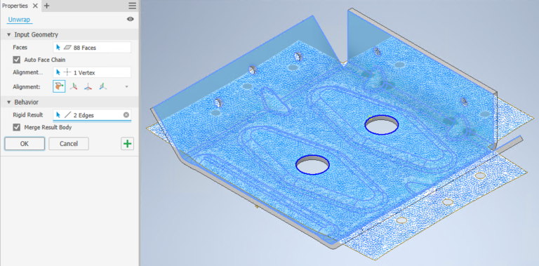

The Unwrap command is further enhanced this release by choosing to align the results with the Model, or the XY, XZ, YZ planes. You can also select multiple planar holes to be Rigid.
To learn more, see Part Enhancements.

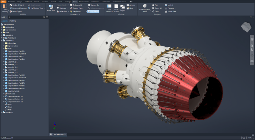

Dark Theme Preview
Inventor 2020 delivered a new Light Theme interface. Inventor 2021 includes a preview of Inventor's new Dark theme.
To learn more, see Dark Theme (pre-release).

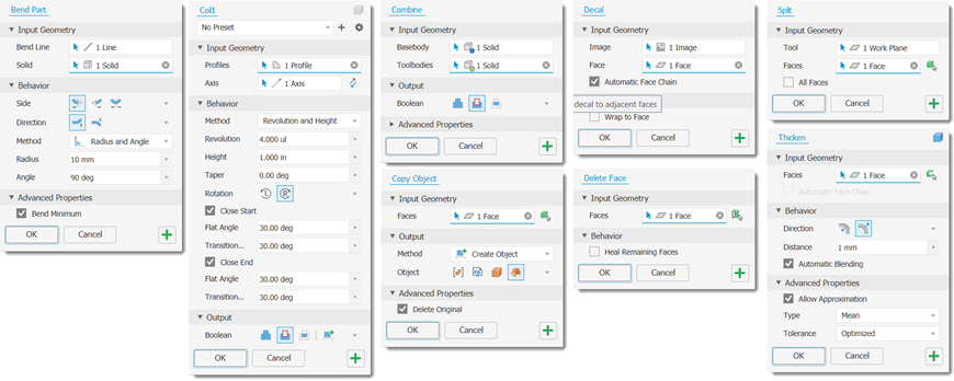

Property panels continue to expand to more areas of Inventor. You can now use the streamlined property panel workflow in Bend, Coil, Combine, Copy Object, Decal, Delete Face, Split, Thicken/Offset, and all frame generator commands.

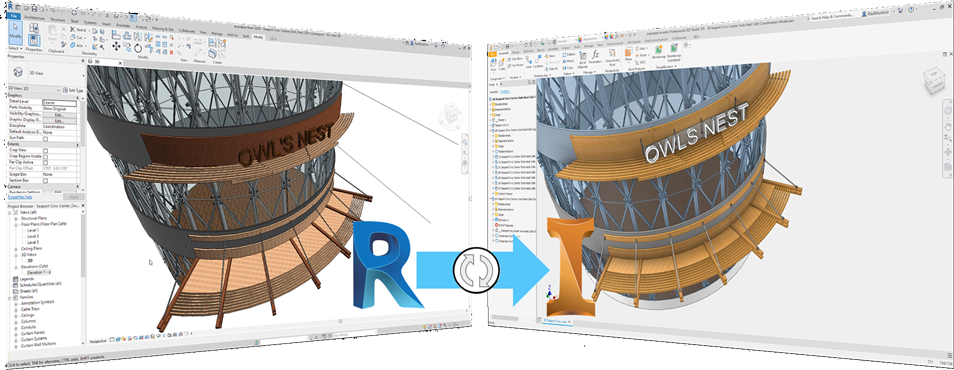

Revit AnyCAD: We know that custom fabricators like you want to provide more value to your customers - by getting involved with Building Information Modeling. Autodesk Inventor is committed to serving companies that are involved in the construction industry by providing seamless integration with Revit data.
  • We have improved the interoperability between Revit and Inventor by maintaining an associative link to inserted Revit data as you work. The Revit project can be accessed from a local file or coordinated via the cloud using the Autodesk BIM 360 common data environment.
  • Changes during the design process are inevitable. When the Revit model changes, we need to update the Inventor model to suit. Because the Revit model is referenced into your Inventor Assembly, without file Translation - any changes to the Revit project will also update inside the Inventor assembly.
To learn more, see Reference Revit Models in Inventor Assemblies.

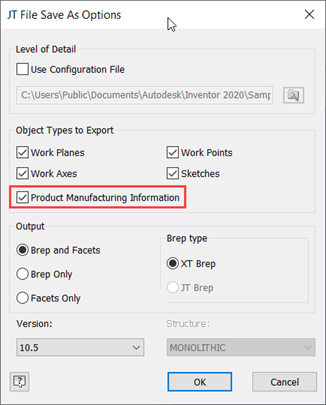

  • JT export now supports export of software interpretable semantic Product Manufacturing Information (PMI). Previously, checking the Product Manufacturing Information box exported graphical PMI data.

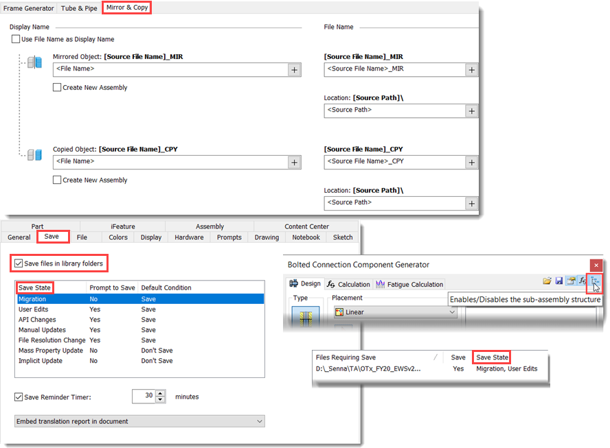

  • We have extended the File Naming dialog to the Mirror and Copy commands.
  • When saving files, we've enabled new options to set the default behavior for whether files should be saved or not. A new 'Save State' column in the save dialog helps you understand what files Inventor is prompting you to save and why.
  • To help you structure your assembly, we've extended the functionality available in the shaft component generator to bolted connections.
    • With this option active, no folder or subassembly is created on disk and the individual components are inserted directly into your assembly. This ability gives you more options for structuring your assembly and organizing your date to best suit your needs.
To learn more, see Mirror & Copy Enhancements, Save Enhancements, and General Enhancements in ASsemblies.

  • We have continued to make improvements to File Naming for Tube and Pipe designs (not available in LT).

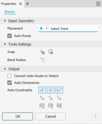

  • We know that you often have more than one Route to create. The Apply button when you use the Auto-Route option lets you stay in the command to create the next route.

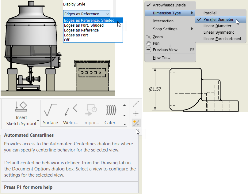

  • Line Style is now Display Style with more options that provide finer control of the appearance of BOM Reference parts in a drawing. Use one of the new options; Edges as Reference, Shaded or Edges as Part, Shaded to show Reference files in color with or without a dashed outline.
  • The ability to add automated centerlines to drawing views has been made easier to discover, with a new button for the automated centerline command in the ribbon.
  • When dimensioning your views we have improved the ability for Inventor to detect diameter dimensions for side views or section views when you select parallel geometry.
  • By popular request, the Measure command has returned to the Tools tab in the drawing environment enabling you to take measurements from the drawing without creating additional annotations.

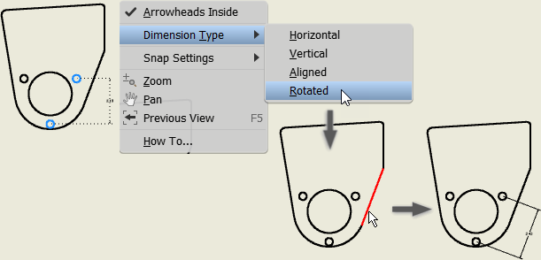

  • The new 'Rotated' option in the Dimension command enables you to align a dimension perpendicular to a selected edge.
  • To help you complete your documentation, we have streamlined the workflow for copying and pasting general tables within a drawing sheet.
To learn more, see Dimension Type Enhancements, General Drawing Enhancements, and Drawing Style Enhancements.

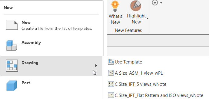

Automated: Sheet formats and iLogic make it easier than ever to automate the creation of drawings to your CAD standard in Autodesk Inventor 2021.
  • View layouts saved as sheet formats now retain view settings such as edge display, and we have included a new 'Fit views to sheet' option to automatically scale your views.
  • Sheet formats now support flat patterns for sheet metal parts and Parts List for assemblies, all automatically populated from the model you reference during sheet creation.

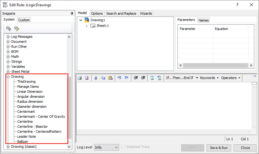

  • To further help you to automate the creation of drawings, we have improved the ability for iLogic to add dimensions, notes, and balloons from labeled features.
  • We have also added support to change drawing styles using iLogic, making it easier to change styles to suit your customer or to batch edit styles to aid CAD standard compliance.
To learn more, see Drawing/Sheet Format Templates Enhancements and iLogic Enhancements.
