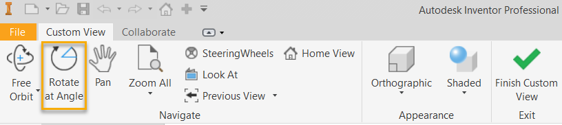

Rotate at Angle now Available in Part and Assembly Files
Rotate at Angle now provides precise camera controls in the 3D model environment.
For more information, see To Rotate Model Views.

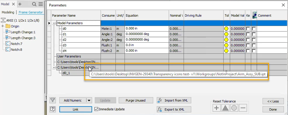

Parameter Enhancement
The User Parameter tooltip now expands to display the full path of the source file where a User Parameter is linked from.
An Inventor® Ideas submission
For more information on Parameters, see To Work with Parameters in Models.

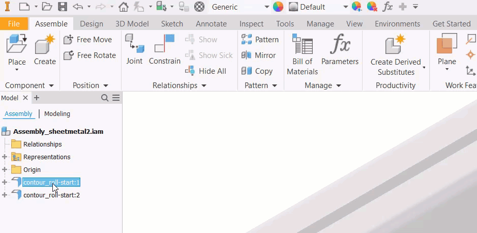

Document Management - Minimize Documents
Documents can be minimized. Minimized documents do not participate in Arrange tasks. To restore a minimized document, click the document tab, click Restore All in the Documents menu, or drag and drop a minimized document by its tab. Minimized documents close when you use Close All.
For more information, see To Work with Graphics Windows.

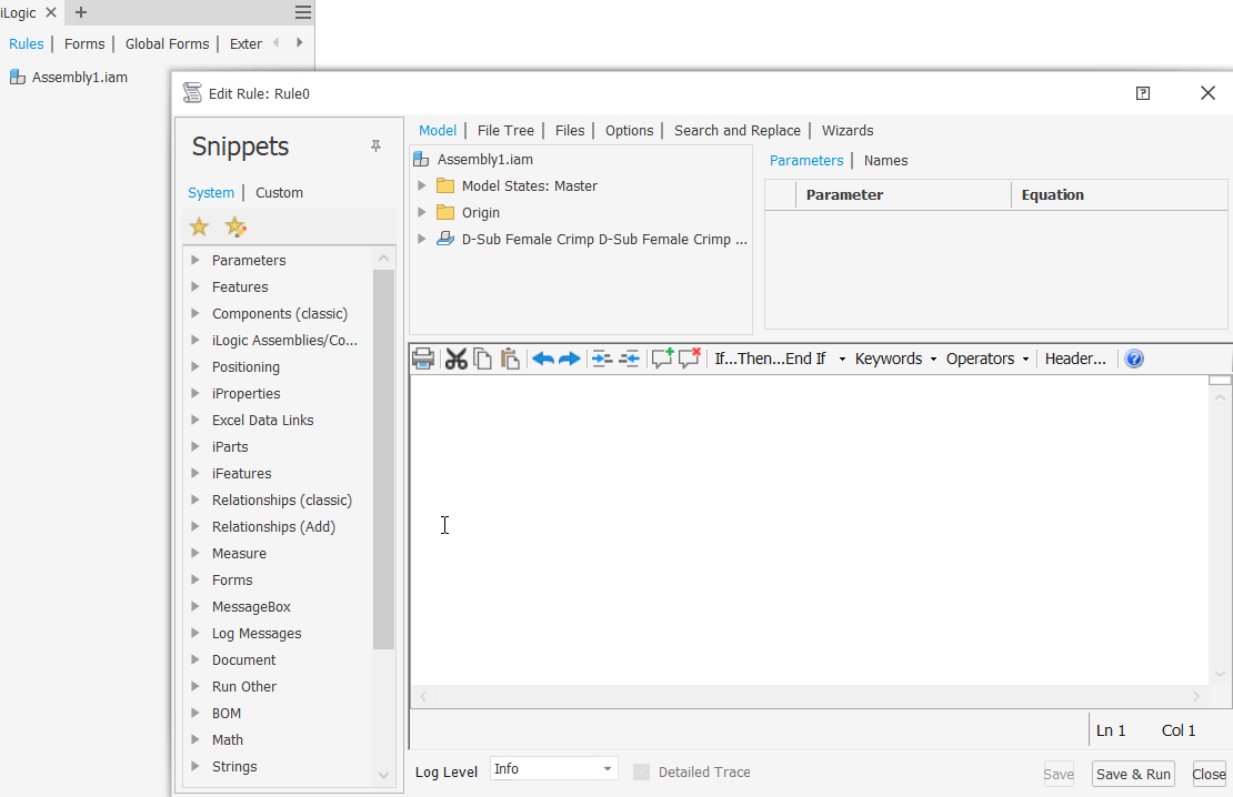

iLogic User Interface
The iLogic user interface is updated with a modernized theme.

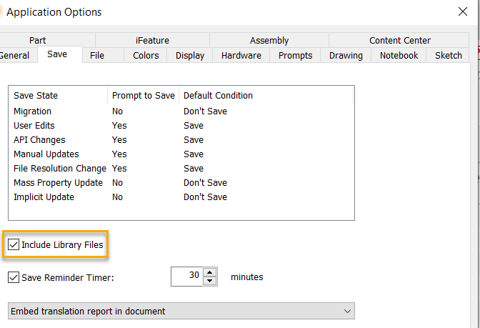

Application Options/Save tab Enhancements
For clarity, the Save files in library folders checkbox is renamed to Include Library Files. In general, the Save tab allows you to control the type of edits you want to be prompted to save and the setting, Include Library Files, allows you to control whether to include library files from the prompting.
For more information, see Save Tab Reference (Application Options).

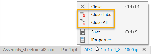

Close Tabs/Files Enhancement
Use the new Close Tabs and Close All context menu options to quickly close all open documents. Access the new options from an open tab's context menu.
  • Close Tabs: Closes all visible tabs.
  • Close All Closes all visible tabs and any files opened from and hidden through the API.
