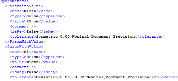

Tolerances in Export and Import XML files
The Parameter Tolerance settings for each model state are now included when you export and import XML files.
For more information, see To Work with Parameters in Models.
