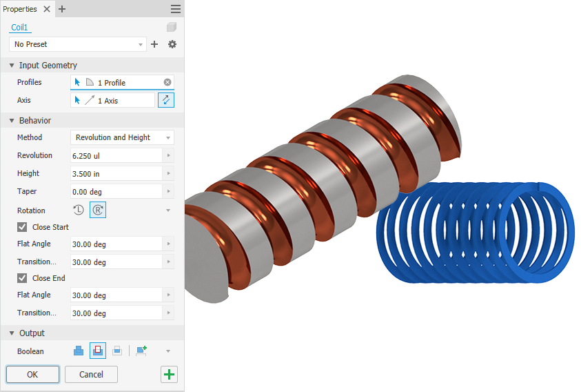

Coil
For more information about the Coil command, see To Create Coils

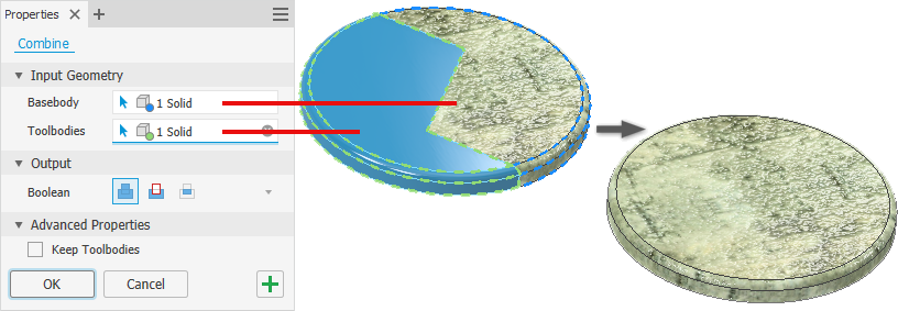

Combine
For more information about the Combine command, see To Combine or Split Bodies or Faces

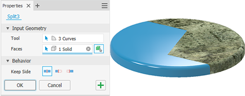

Split
For more information about splitting faces and bodies, see To Combine or Split Bodies or Faces

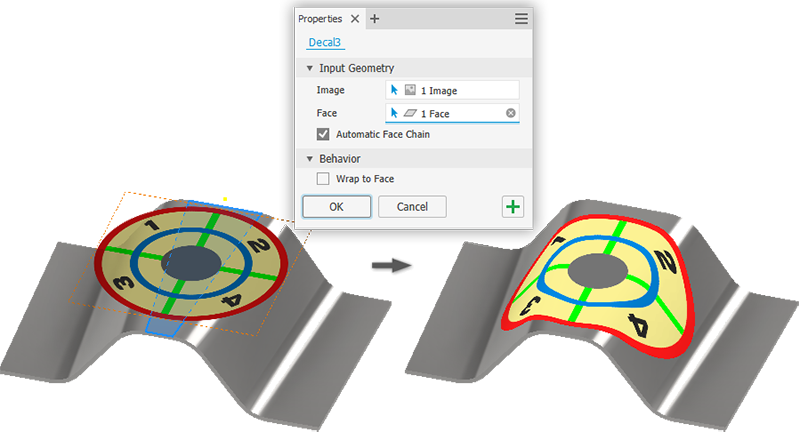

Decal
For more information about Decals, see To Emboss or Add Decals to Parts or Surfaces

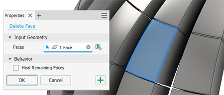

Delete Face
For more information about deleting faces, see To Delete or Replace Faces

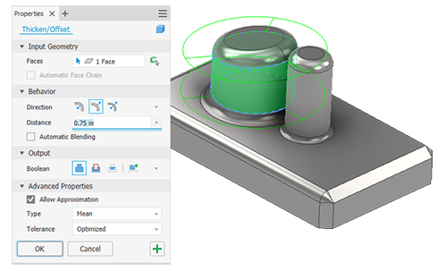

Thicken/Offset
For more about the Thicken/Offset command see: To Thicken Faces or Offset Surfaces

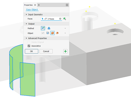

Copy Object
For more about the Copy Object command see: To Copy Objects Between Part, Assembly, and Construction Environments

Input highlighting and notifications have been enhanced. This can be seen in commands, such as the Combine command, where more than one selection is required. When satisfied, each field has a colored dot that corresponds to the selection highlight in the graphics window. The active selector field is underlined.

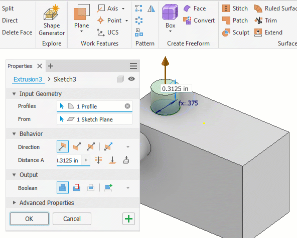

Value Edit controls and HUD - After selecting a feature dimension, the cursor is positioned at the end of the field. Improves support for creating formulas or equations.
Sketch
Using the property panel breadcrumb you can switch from the feature edit environment to the sketch environment. You can also click Return to in the ribbon.
For more information about moving between environments, see To Enter and Leave an Environment.
