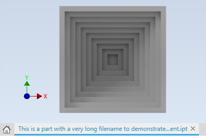

Document tabs
  • Document tabs display more of the document name. Tabs resize based on the number of open documents and window size.
