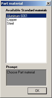

InputListBox function in iLogic
Displays a message box with a list of available values. When a value is selected from the list, the function returns that value.
Syntax
d0 = InputListBox("Prompt",MultiValue.List("listName"), defaultEntry, Title := "Dialog Title", ListPrompt := "List Prompt")
"Prompt"
Message to appear above the OK button in the box.
Name of the multi-value list to use.
defaultEntry
Value selected initially in the list box.
Title
Text to appear in the title bar.
ListPrompt
Message
Text to appear above the list in the box.
Returns
d0
Value from the list that was selected.
Example
material = InputListBox("Choose Part material", MultiValue.List("material"),  _
material, Title := "Part material", ListName := "Available Standard materials")
