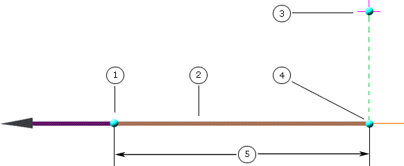

Note: The distance between the connection point and the perpendicular root determines the MaxEP distance, but not the actual position of the maximum engagement point. For example, if the connection direction points to the right in the above planar draft, the MaxEP reverses to the left to the connection point.

You can also use work points outside the connection axis, but it is not recommended. Using such work points, Autodesk Inventor calculates the perpendicular root of the work point on the connection axis, and then the MaxEP transforms to the distance between the connection point and the perpendicular root.
The following planar draft illustrates how a work point outside the connection axis defines the MaxEP:
1 - Connection point; 2 - Connection axis and direction; 3 - Work point outside the connection axis; 4 - Perpendicular root of the work point; 5 - MaxEP
