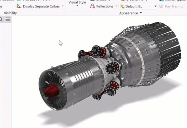

Display components in separate colors
For assemblies, you can now temporarily display components with separate colors. Displaying components in unique colors can assist in selection and in understanding component spatial relationships, and more. You can also define the colors you want to use when displaying separate colors.
Access Display Separate Colors in the View tab Visibility panel.
For more information, see To Display Components with Separate Colors).

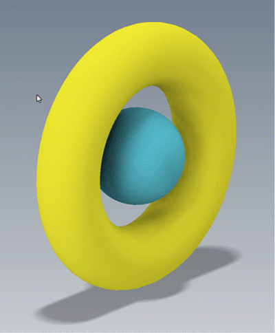

Improved Highlighting
The highlighting for a sphere, cylinder, or torus, etc. has been improved to better distinguish the item of focus.

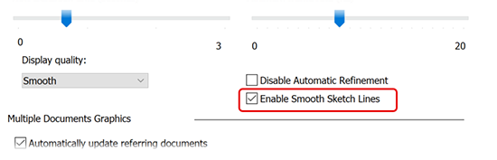

Line display improvements
Sketch geometry display is improved so curves display smoother. This application option for line display is on by default.
For more information, see Display Tab Reference (Application Options).
