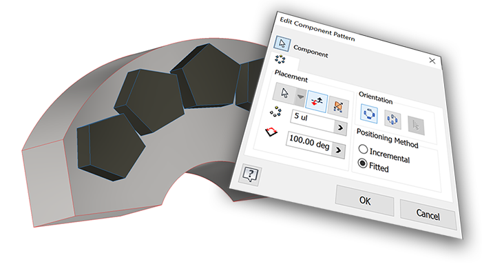

Circular Pattern
Circular pattern for components is enhanced to provide incremental and fitted positioning methods.
For more information see Create circular patterns of components
