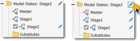

  • iProperties
  • Parameters
By changing the Edit Scope toggle in the browser, you can decide if edits apply only to the active member or all members.

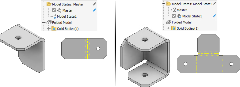

Sheet metal parts also benefit from model states. By using Model States you can now create configurations with unique folded features and flat patterns.
