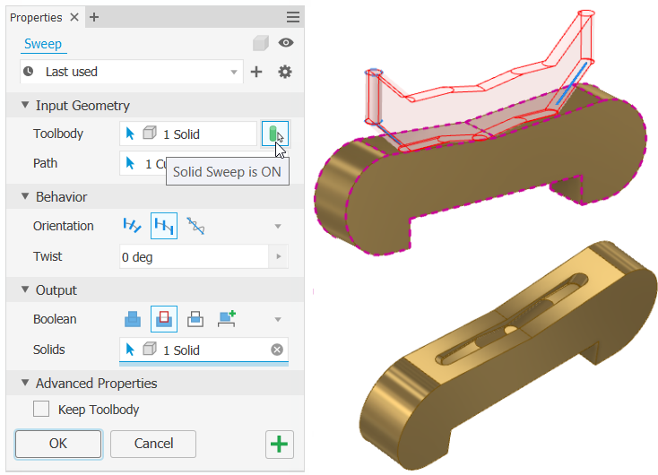

Solid Sweep
An Inventor® Ideas submission
In addition to a new property panel for a streamlined workflow, Solid Sweep enables sweeping a solid toolbody along a path. The following example shows a Fixed sweep path with no twist to simulate a toolpath.
The next example shows the effect of using a 90-degree twist in an Aligned sweep to design a feed screw that rotates a bottle from horizontal to vertical.
(Model credit: Scott Moyse)
For details, see To Create Sweeps.

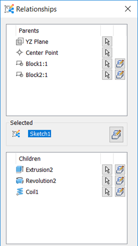

Relationships Enhancement
Sketch blocks consumed by features now display in the Relationships dialog box.
For details, see To Find Relationships in Part.
