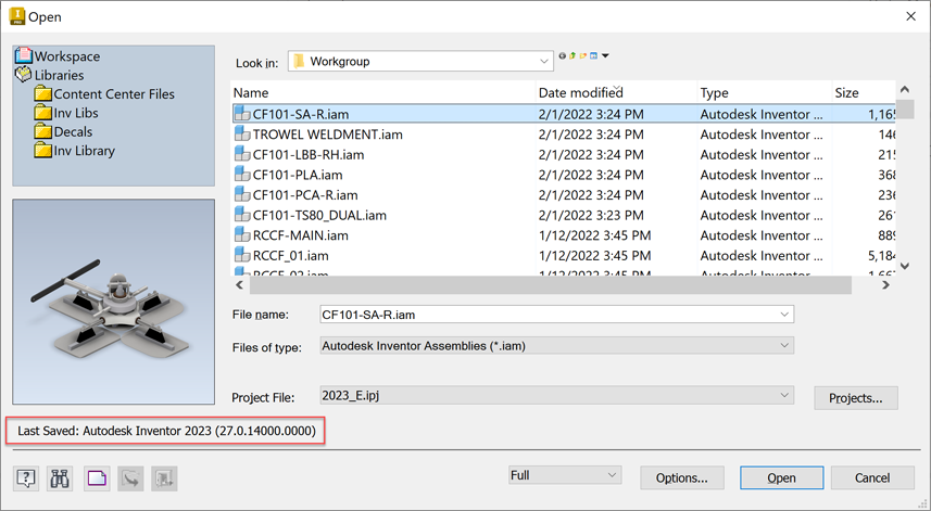

  1. Use the Open or Place command to create a reference the newer version of an assembly file:
    • File Open.
    • In an assembly file, On the ribbon, click Assemble tab Component panel Place.
  2. Browse to and select the newer assembly file (.iam) to open.
  3. Optionally, click Options to open the File Options dialog box and specify the specify the Design View and Positional Representation. Click OK.
  4. In the Place Component dialog box, click Open. Solid and surface bodies are created.
    You can place multiple instances as needed.

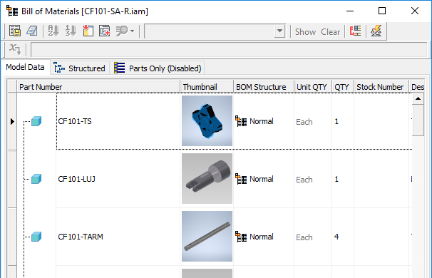

  • Bill of Materials displays the referenced components in the assembly.

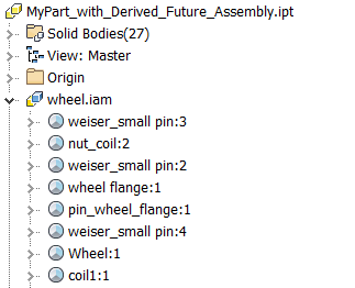

To Derive a Version of an Assembly File One Year Newer
This workflow creates a reference to a newer version of an assembly file in a part file.

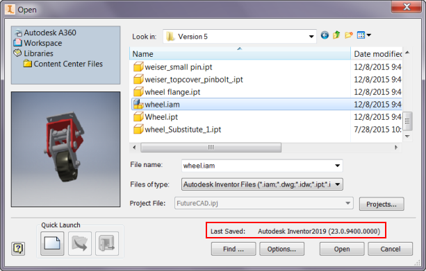

  1. In a part file: On the ribbon, click Manage tab Insert panel Derive .
  3. Optionally, click Options to open the File Options dialog box and specify the Design View and Positional Representation. Click OK.
  4. In the File Open dialog box, click Open. Solid and surface bodies are created.
Resulting file
  • The browser displays the referenced newer file.
  • The derived assembly feature is editable.
  • The file can be saved and reopened by any installation of Inventor of the same version.
