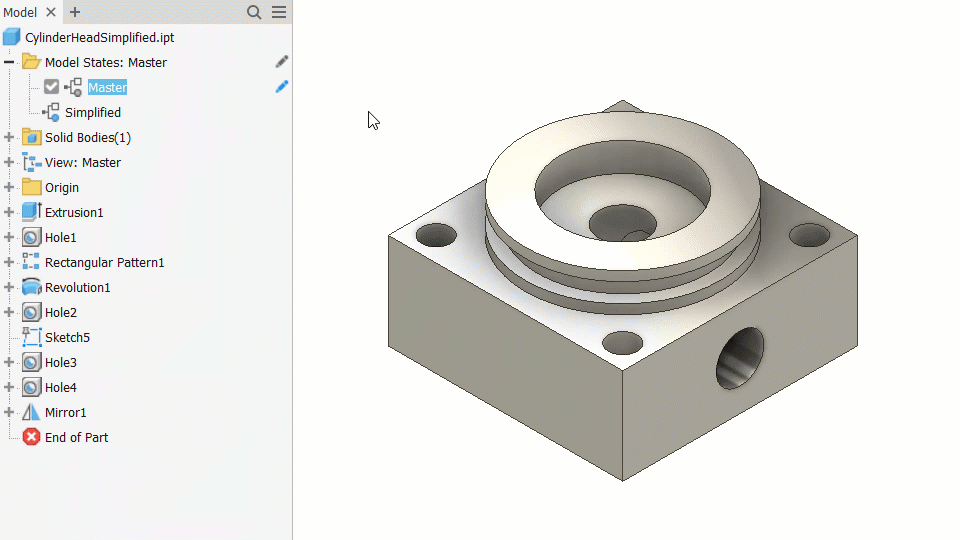

  • Model States: Create manufacturing states, simplification levels, and more in the same part or assembly file.
