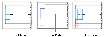

Position the side lock
In general, the male lock attaches to the bottom face of the top plate. The female lock attaches to the top face of the bottom plate. To attach a side lock, first define the base face, the reference face, the distance, and the offset.
- Base face The top or bottom surface of the mold base plates, which establishes the location of the parting plane.
- Reference face The face to which the side lock is attached.
- Distance The measurement between the center of the reference face and the center of the side lock.
- Offset the distance into the mold plate that the side lock is embedded. Negative values mean that the side lock is external to the mold base plates, and positive values indicate that the side lock is embedded.
