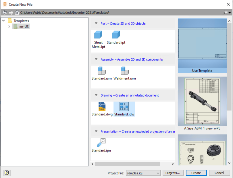

  • From the Create New File dialog box: Drawing templates are now available in the column on the right. Thumbnails show the Sheet Formats saved in the drawing template file.

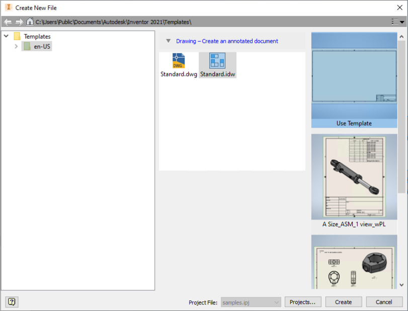

  • In a part or assembly file: The context menu option, Create Drawing View, now launches a streamlined Create New File dialog box. Thumbnails show the Sheet Formats saved in the drawing template file.

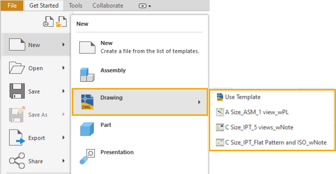

  • From the File menu: The new flyout menu lists the drawing templates and any Sheet Formats saved in a drawing template file.
