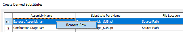

Productivity Tools
In the Create Derived Substitutes dialog box, you can remove a row by right-clicking the row, not just the left most cell.

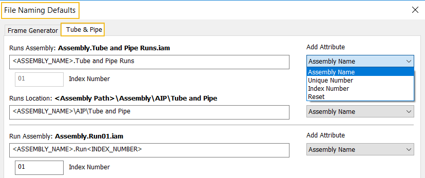

Tube & Pipe
The Application Options File tab File Naming Defaults dialog box now includes a Tube & Pipe tab where you can specify how Tube & Pipe creates files and folders. For example, you can use these settings to keep the folder structure flat and completely eliminate the AIP sub-directory. In addition, you can now configure the naming scheme using the options in the new Add Attribute drop-list.
An Inventor® Ideas submission
For more information, see To Customize the Tube & Pipe Folder Structure.

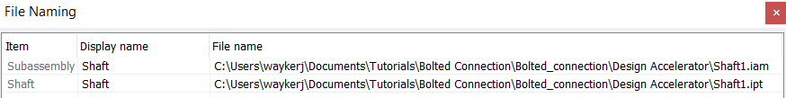

Design Accelerator/Shaft Generator
The Shaft Component Generator dialog box now includes a toggle that allows you specify how files and folders for Shaft components are created.
By default, the toggle disables the creation of a sub-assembly structure and creates a single part within your root assembly.
Click the toggle to enable the creation of a sub-assembly .
For more information, see To Design a Shaft Using Functional Input.

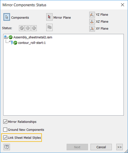

Mirror Components/Sheet Metal Enhancement
The Mirror component command now recognizes a sheet metal part and lets you link the sheet metal style of the source component to the mirrored copy.
For more information, see Mirror Components.
