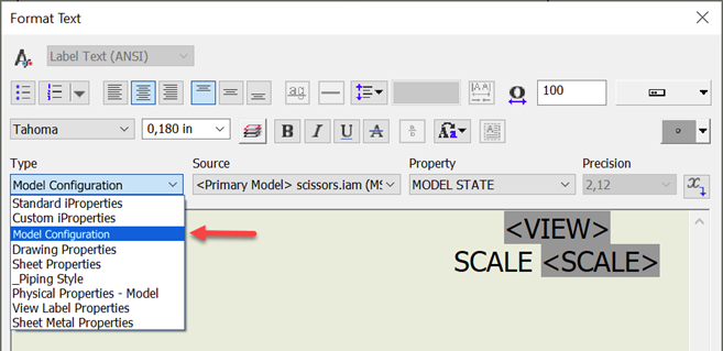

Model State Name within View Label in Drawings
A new "Model Configuration" category is added to the Type combobox in the Format Text dialog which enables you to configure view labels to display a model state name in the drawing views. Any edits to the view model state are reflected in the view label.

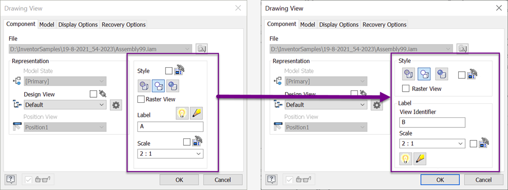

Improved User Interface related to View Labels
  • View label options are reorganized in the Drawing View dialog box to provide more clarity.
  • In the Format Text dialog, the VIEW property is renamed to VIEW IDENTIFIER to be consistent with view dialog boxes.
  • In the Format Text dialog, names of the View Label Properties are localized appropriately and appear in the current Inventor language.
