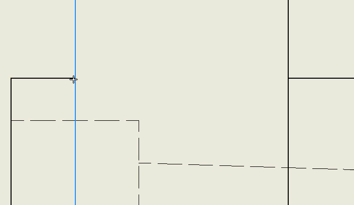

Align Perpendicular to a Selected Edge
You can now align a dimension to a selected edge. Use the new dimension type, Rotated, to place a dimension and position it perpendicular so that it aligns to the selected edge.
  1. Select linear edge or 2 points.
  2. Right-click, and select Dimension > Rotated.
  3. Select a line to establish parallel or perpendicular direction of the dimension.

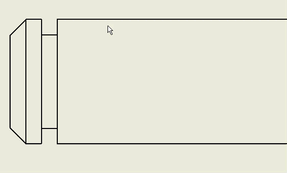

Parallel Diameter with a Ø symbol
A new dimension type, Parallel Diameter with a Ø symbol, is created when you select the silhouette edge of a cylindrical feature (shaft or hole).
You can use the context menu option, Dimension Type, to change the dimension type.
