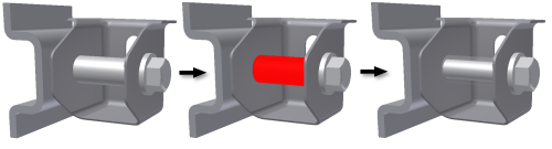

To simplify an assembly model, exclude small parts with functionality that is simulated by constraints or forces. Suppress parts that do not carry significant loads or are not critical to structural or thermal integrity for the design, and play no role in simulation results. Exclusions are simulation-specific.
Exclude components from simulation
  • Component is removed from the list of components participating in the simulation.
  • Any component can be excluded in any simulation.
  • Excluded components are still visible in the assembly, and if you change environments to the assembly environments.
Suppress component
  • Component is visible in the assembly or other environments, including simulation.
  • Component cannot be used in any simulation.
Exclude assembly component from analysis
  1. In the assembly browser, expand the nodes. Right-click a component node, and click Exclude From Simulation
    or
    In the graphics area, right-click the component and click Exclude From Simulation.
  2. The display of the excluded component changes to transparent while in the simulation environment.

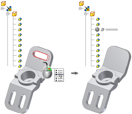

Exclude features from analysis
Exclude features from analysis to expedite the meshing process. In the Part or Assembly modeling environment, exclusions from analyses are ignored.
Note: You cannot exclude features that are suppressed in the modeling environment.
  1. Exclude features in the graphics area.
  2. On the ribbon, change the select filter to Select Features .
  3. In the graphics area, select one or more features to exclude.
  4. Right-click, and click Exclude From Simulation.
In the graphics area, the features and their dependent features become invisible. In the browser, the features and their dependents are unavailable and display the Exclude icon .
