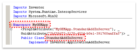

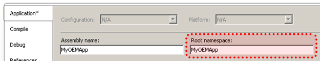

    The “name” attribute of the clrClass element consists of three parts, separated by periods. The first is the name of the root namespace, which is highlighted below.
    The second part is the namespace that the COM class is defined within. For this example is it MyOEMApp and is highlighted below. The Last piece is the name of the class that implements the ApplicationAddInServer interface, which is “StandardAddInServer” in this example and is also highlighted below.

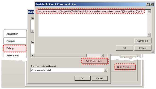

  2. The next step is to add a post-build process to incorporate this manifest into your dll. The post-build process calls mt.exe which is a Microsoft utility that will embed the manifest into your add-in’s dll. You define a post-build step through the Compile tab of the Application Properties dialog. On the Compile tab, click the “Build Events…” button and then on the “Build Events” dialog click the “Edit Post-build…” button. Finally enter the lines below into the “Post-build Event Command Line” dialog, as shown below; OEMTestAddin is the name of your add-in.
    call "%VS100COMNTOOLS%vsvars32"
    mt.exe -manifest "$(ProjectDir)OEMTestAddin.X.manifest" -outputresource:"$(TargetPath)";#2

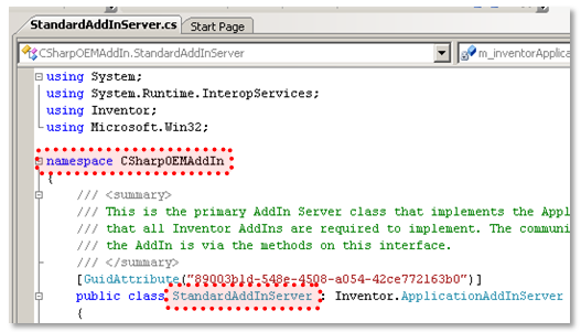

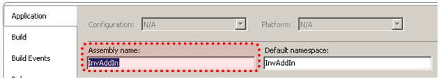

    The “name” attribute of the assemblyIdentity element is the name of the assembly, which is highlighted below.
    The “name” attribute of the clrClass element consists of two parts, separated by periods. The first is the name of the namespace that the COM class is defined within. For this example is it CSharpOEMAddIn, and the second part is the name of the class that implements the ApplicationAddInServer interface, which is “StandardAddInServer”. Both of these are highlighted below.

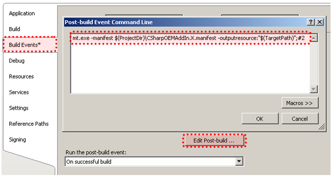

  2. The next step is to add a post-build process to incorporate this manifest into your dll. The post-build process calls mt.exe which is a Microsoft utility that will embed the manifest into your add-in’s dll. You define a post-build step through the Build Events tab of the Application Properties dialog. On the Build Events tab, click the “Edit Post-build…” button. Enter the string below into the “Post-build Event Command Line” dialog, as shown below. Replace InvAddin with the name of your add-in.
    mt.exe -manifest $(ProjectDir)INVAddin.X.manifest -outputresource:"$(TargetPath)";#2

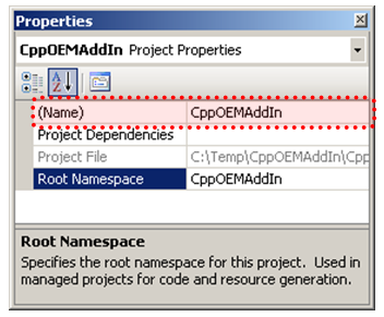

    The “name” attribute of the assemblyIdentity element is the name of the project, which is highlighted below.

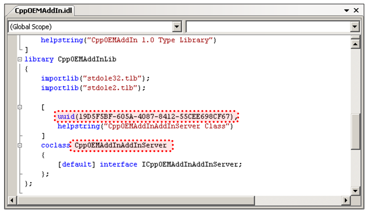

    The clsid is the class ID for your add-in and can be found in the .idl file associated with your add-in, which is shown below. Remember that the braces are required in the manifest file.
    The “name” attribute of the clrClass element consists of two parts, separated by periods. The first part is the name of your project. For this example it is CppOEMAddIn. The second part is the name of the class that implements the ApplicationAddInServer interface, which is “CppOEMAddInAddInServer” for this example, as shown below.

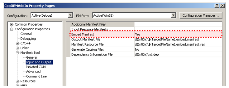

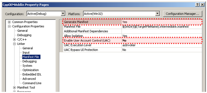

  2. The next step is to configure some project settings so the manifest is correctly embedded within the dll. The first two settings are part of the Linker settings. The settings and the values to change them to are highlighted in the picture below. Some of these settings may already have the correct value.
    The next setting is of the Manifest Tool settings. Make sure the “Embed Manifest setting is set to “Yes”, as shown below.

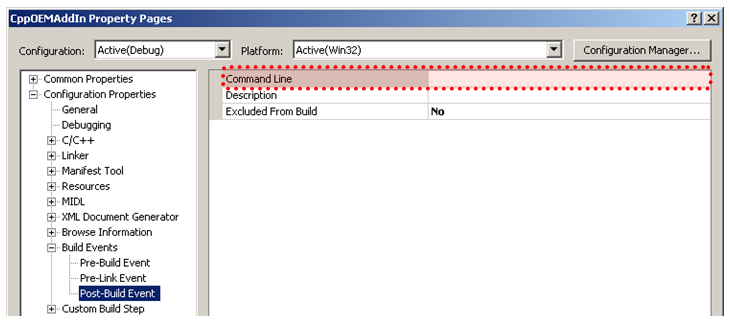

    Finally you want to remove the post-build step that registers the add-in in the registry. This is found in the Build Events section of the settings. Clear out any text in the Command Line field, as shown below.

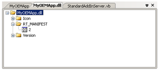

    You can verify that the manifest has been correctly embedded by dragging the add-in dll into Visual Studio. You should see the “RT_MANIFEST” folder, as shown below. Double clicking on the “2” icon will open a window to show you actual manifest data.
