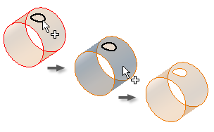

Use Boundary Trim to clean and repair trimming curves that result from poorly translated surfaces. Boundary Trim rebuilds a surface to leverage wires or edges on adjacent surfaces. The edges and wires must create a closed loop for use as a new trimming curve, and they must be within the bounding area of the surface. The following is a typical workflow in which Boundary Trim repairs a translated surface:
  1. Extract one or more loops from a surface (using Extract Loop), leaving an untrimmed surface.
  2. Use the Boundary Trim command to rebuild the untrimmed surface.

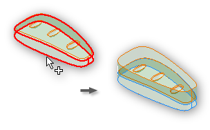

Extracting Loops to Untrim a Surface
When you extract one or more loops, you untrim a surface, replacing it with one that is not trimmed by the original edges. Once extracted, the loops become wires, which, along with other wires or edges, can be used to form a new trimming curve
When the original wires have formed poor quality trimming curves, you can use the edges of other surfaces to form a trim boundary. You can also use a combination of the original wires and the edges of other surfaces. The Extract Loop command includes a Delete Wires option, so you can delete the existing edges of the surface rather than change them to wires.
