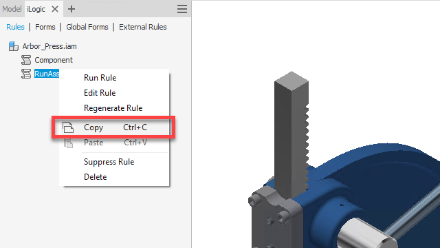

iLogic Enhancements
Copy & paste a rule within the iLogic browser
The copying and pasting of rules in the iLogic browser is much easier now. You can select the iLogic rule directly in the browser, use the Copy command from the context menu and paste it into another part or assembly.
You can also paste the rule to the same document within the Rules tab.
For more information, see To Work with Rules in iLogic.
