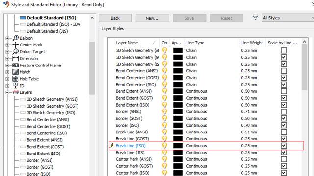

Also, a change was made to the "Break Out Line" object type for ISO standards. Until now, the "Visible" layer on "Thickness" was set to 0.5 mm. Now, as per the updated standard, the "Break Out Line" object type uses the "Break Line" layer by default with a thickness of 0.25 mm. This also applies to DIN/GB/JIS standards.
