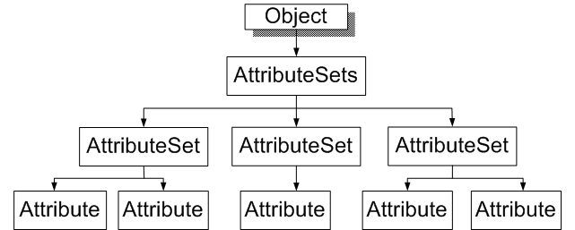

AttributeSet and Attribute Object Model Diagram
