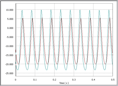

  12. Expand the Reciprocating Saw cam1.iaa node and then expand Traces.
  13. Expand Trace:1 and then expand Positions.
  14. Click P[Z] to display it over the other simulations Trace. You can compare simulation results in this way.
