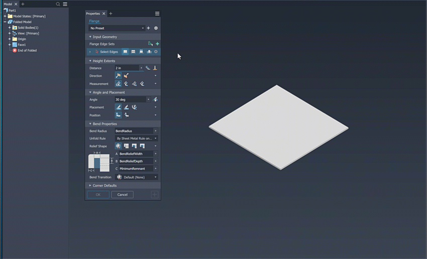

The following Sheet Metal commands have been modernized, incorporating the property panel interface and workflows. Quickly and easily create sheet metal flange, face, and cut features. Take advantage of the updated interface and workflows to improve your sheet metal tasks.
- Property panel workflows
- Everything in one panel, no tabs
- Supports Light and Dark themes
- For general information about property panel use, options, and menus, see About Property Panels
- Includes Preset capabilities, see To Work with Presets
Face
For more information see To Work with Faces in Sheet Metal.
Flange
For more information see To Work with Flanges in Sheet Metal.

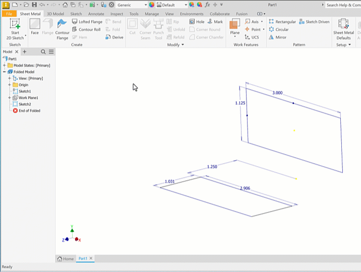

Cut
For more information see To Work with Cuts on Sheet Metal.
Other Sheet Metal Improvements
- Cut
Region selection has been improved for the Cut command.
- Export Flat Pattern as DXF
A new layer, IV_UNCONSUMED_SKETCH_CONSTRUCTION, is added to the DXF export options. All exported construction geometry is placed on that layer. If the layer is turned off, no construction geometry is exported.
