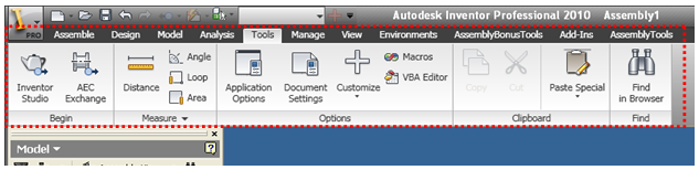

Ribbon
The ribbon is the entire area highlighted below and is represented by the Ribbon API object.

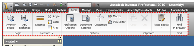

Ribbon Tab
Each ribbon consists of a set of tabs. The Tools tab of the Assembly ribbon is highlighted below. These are represented in the API by the RibbonTab object. There can be any number of tabs, although there’s a practical limit to what will fit on the screen. Tabs can be visible or not. Each tab also has an internal name that can be used to find it.
Ribbon Tab

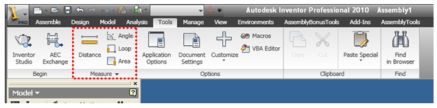

Ribbon Panel
Each tab consists of a set of panels. The Measure panel of the Tools tab is highlighted below. These are represented in the API by the RibbonPanel object. There can be any number of panels in a tab, again with a practical limit, and they can be visible or not. Each panel also has an internal name that can be used to find it.
Ribbon Panel

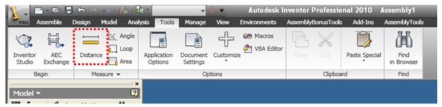

Command Control
Each tab contains a set of controls. The button control for the Distance command is highlighted below. All controls are represented in the API by the CommandControl object. Each control also has an internal name that can be used to find it; however their internal name isn’t explicitly defined but is inherited from the ControlDefinition object it references.

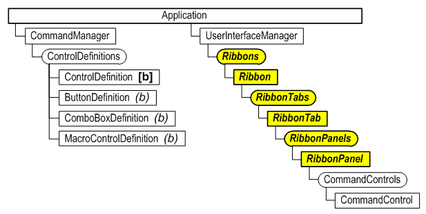

Ribbon API Object Hierarchy
Below is the object hierarchy for the portion of Inventor’s API that works with the ribbon. The highlighted items are the objects specific to the ribbon. The others are objects that are also used in other areas of the API.
API Object Model for the Ribbon

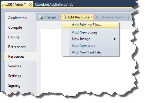

Your images can be added as resources to your add-in project using the Resources tab in the Properties dialog for your project, as shown below. Choose the “Add Existing File…” option in the “Add Resource” dropdown to select your files and add them as resources.

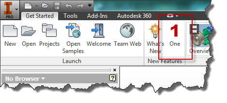

The result of loading this add-in is shown below.

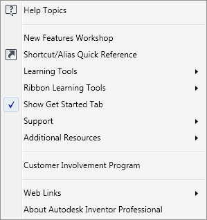

Separators are also supported by the ribbon although they’re not as common since the panels serve the same purpose of grouping commands. They’re most common in the Application and Help menus. The picture below shows the help menu in the ribbon with its three separators. To create a separator you use the AddSeparator method of the CommandControls object.
Ribbon Sample Results

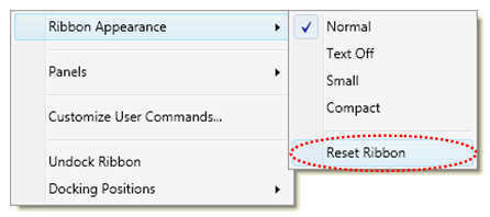

Handling Resets in the Ribbon Interface
The user can reset the ribbon interface to restore it to its original state. This has the side effect of removing any customization that add-ins have done. Most users will expect a reset to take Inventor back to its initial interface plus any customization that add-ins have done to add their buttons. To accomplish this, an add-in needs to react to a reset by recreating whatever customization it did. An add-in does this by listening to events. In the ribbon interface the user can use the Reset Ribbon command to reset the entire ribbon interface back to its initial state. The Reset Ribbon command is invoked through the ribbon’s context menu as shown below.
For an add-in to handle the Reset Ribbon command it needs to listen to the OnResetRibbonInterface event. All you need to do in response to this event is exactly what you did when the add-in was executed for the first time. The code below illustrates this by calling the same function that was called in the Activate method of the add-in.
Private Sub m_uiEvents_OnResetRibbonInterface(...) Handles m_uiEvents.OnResetRibbonInterface
    CreateUserInterface()
End Sub
