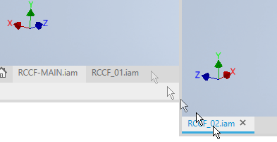

You can use a single Inventor session in multiple windows and with multiple monitors. The new window management commands allow you to:
  • Drag document tabs outside the main inventor window onto another monitor. Not available when a command is active.
  • Arrange documents side by side, top to bottom in various configurations.
  • Window tile toggles are moved to the advanced drop-down menu at the far right of the document tab bar.
  • Clean Screen also hides the document tab. Propose: "If you want to work without the browser, document tab, and ribbon and maximize your workspace, use the Clean Screen toggle. "
  • Model Browser and dockable windows can be docked to the primary or secondary window frames.
    Note: The Ribbon docks only to the primary window frame.
