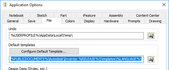

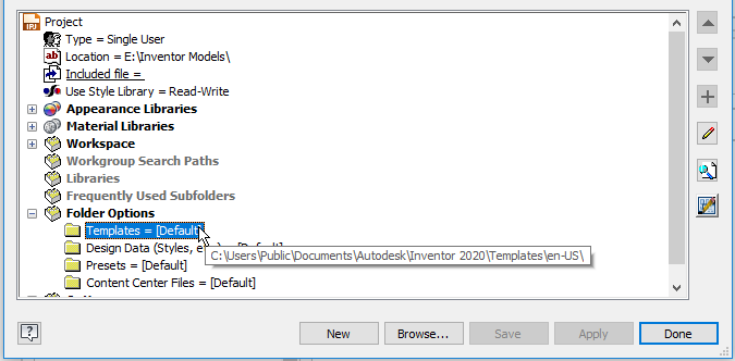

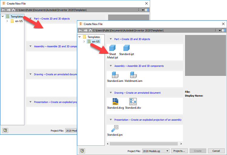

The following images show the places inside Inventor where Template file paths are managed or shown:
