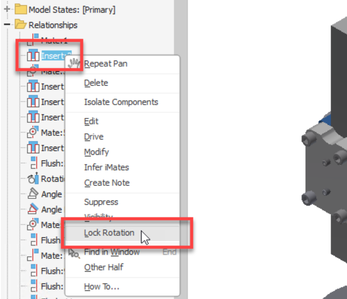

Lock Rotation in Constraints
Previously, to lock a constraint location, it was necessary to select the "Lock Rotation" option in the dialog box. Now, the "Lock Rotation" option has been directly incorporated into the context menu for the Insert constraint type. This option is also available when multiple Insert constraints are selected.
