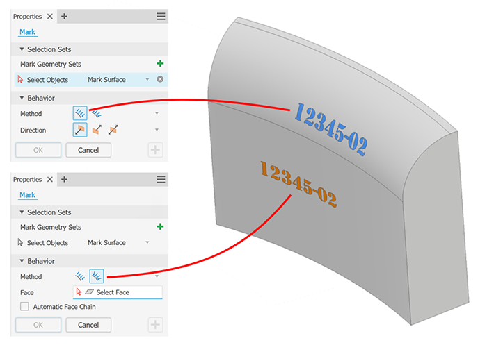

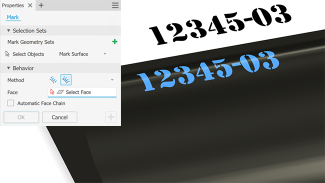

The Mark feature is improved to support the following:
  • Using non-coplanar sketches to define the mark sketch geometry.
  • Wrapping or projecting the sketch to a non-planar face.
Markdown card metadata
Use the Project option for complex faces and the wrap option for simple curved faces.
For more information see To Mark Faces.
