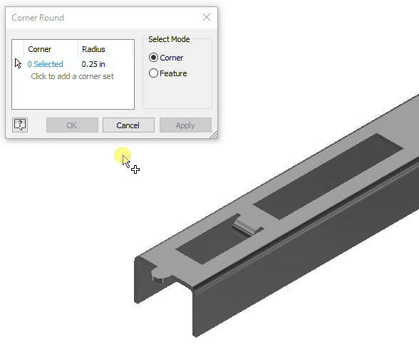

Sheet Metal Enhancements
Previously, it was necessary to select corner edges one by one when rounding and chamfering corners using the Corner Round and Corner Chamfer commnads. Now, you can use the window select method to select the edges for rounding and chamfering.
