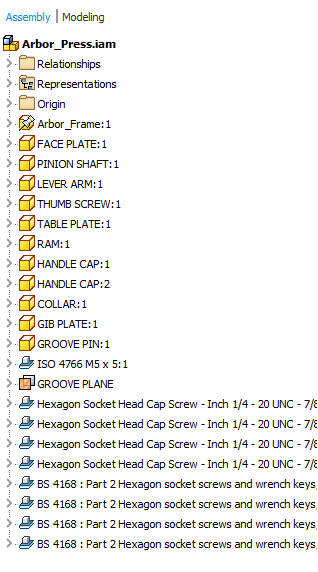

Issue:
It's not possible to reorder or move work features and component patterns in assembly browser in Inventor by drag-and-drop.
User-added image

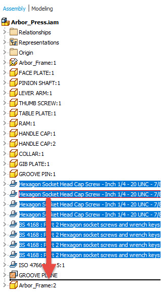

  1. Add at least one dummy component right below the element you want to move in Inventor browser temporarily to have one movable component :
User-added image

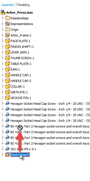

  1. Do the reverse order: Move all the "normal" elements to the desired position.
User-added image
  1. Remove or delete the dummy component.
User-added image
