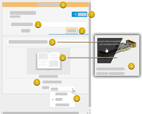

Guided Tutorial Interface
The tutorial interface has two main sections separated by tabs, Tasks and About.
  1. Tutorial Title - can be entered on either tab.
  2. About tab
  3. Tutorial description - enter a description that helps the audience know what they will learn from the tutorial. The description displays when the cursor is over the tutorial in the gallery.
  4. Thumbnail image - click to add the image to the tutorial.
  5. Author - the active user name. Not editable.
  6. Tutorial Type - choose from Quick Start, Basic, and Intermediate.
  7. Share - click to share the tutorial.
  8. Share status - status is both textual and color coded to make it easy to know whether or not the tutorial is shared.
  9. Tutorial gallery - the tutorial thumbnail, title, description, release and download count display in the gallery.
  10. Same as item 1.
