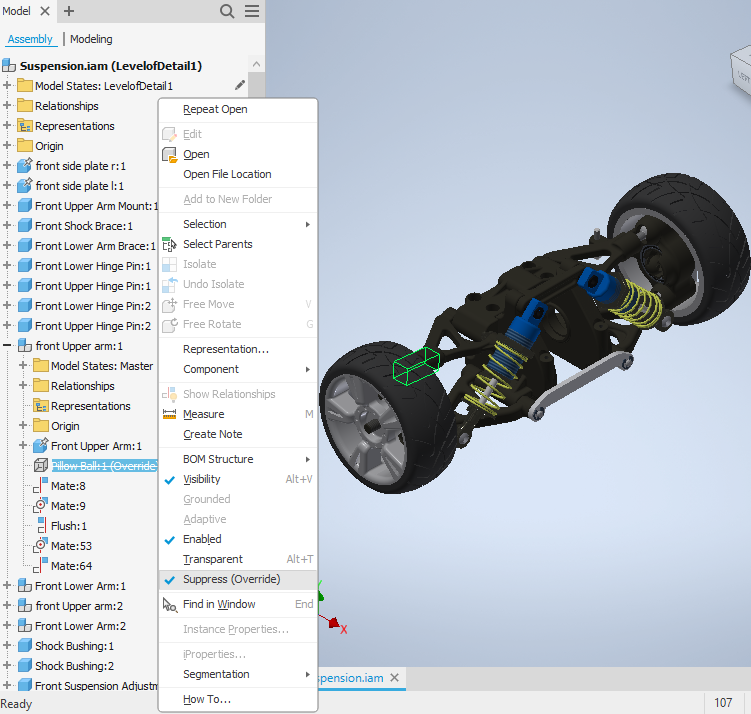

2. In legacy assembly data the iAssembly and LOD can exist in the same assembly file, while since Inventor 2022 the iAssembly and model states are mutually exclusive.It means ModelState is not supported in iAssembly document, and vice versa. Like ComponentOccurrences.AddiAssemblyMember doesn't support the ModelState in Options argument.
3. Suppress ComponentOccurrenceProxy is not allowed. If a legacy data has a suppressed ComponentOccurrenceProxy then you can only unsuppress it in Inventor 2022 to remove the Suppress(Override) status:
