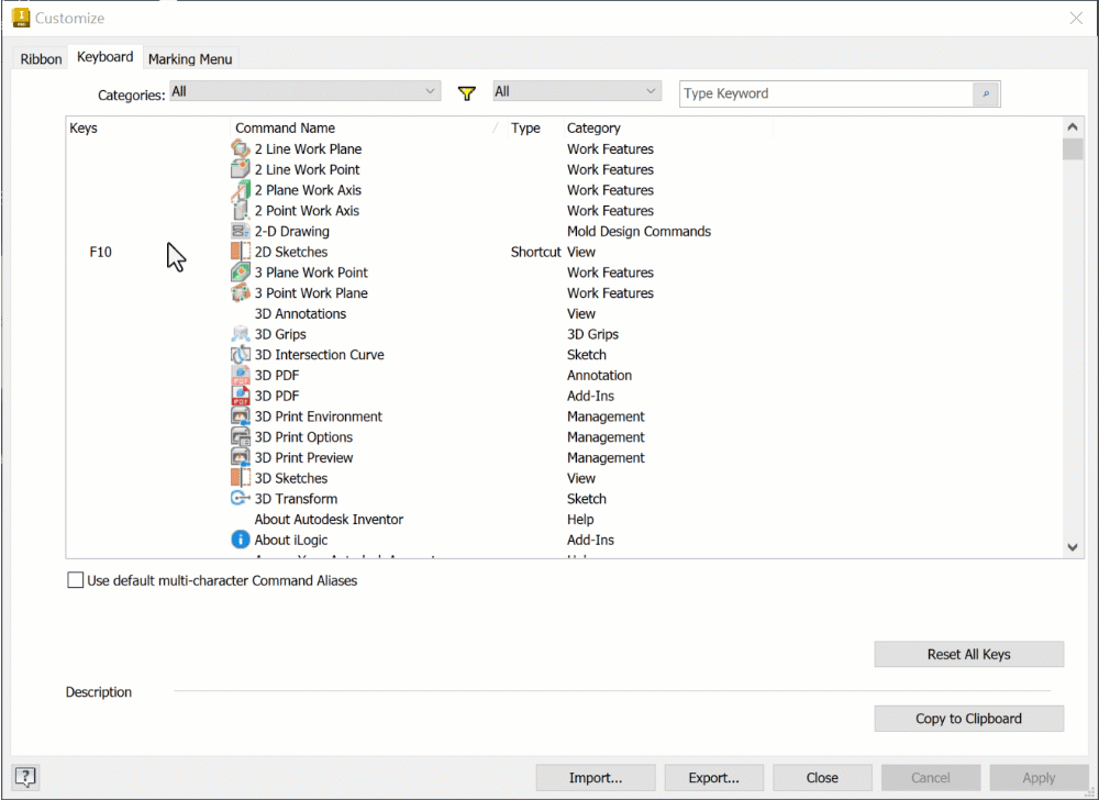

Customize Shortcuts now has Search
When setting up custom keyboard shortcuts you can use the search command to quickly locate commands.
For more information see To Work with Custom Command Aliases and Shortcuts.

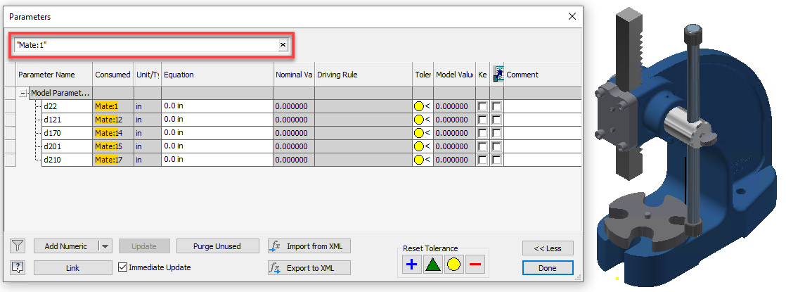

Search in the Parameters dialog box
You can now quickly find parameters using a new search box added to the top of the Parameters dialog box. The search results auto-update as you specify the search criteria and highlight the matched search. Search is performed in all parameter fields and you can combine various search criteria or limit the search as needed, in a needed column, for example.
For more information see To Work with Parameters in Models.
For more information about possible search options see Search Options Reference.

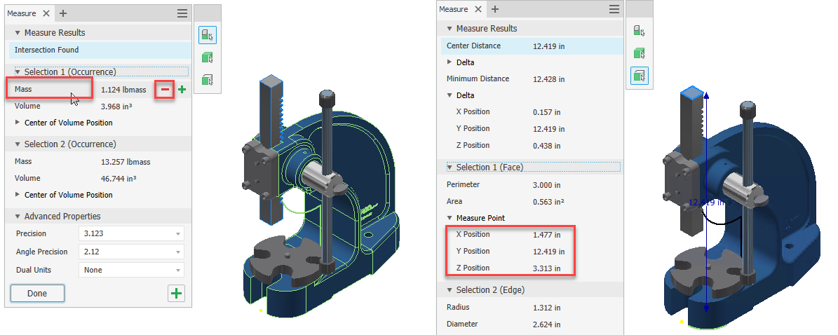

Measure Enhancements
The following enhancements were made to the Measure command for this release:
- It is now possible to measure distance between the sketch point and a non-planar face.
- A new "Subtract from accumulated value" button is added for the following values: volume, area, distance, angle. You can subtract the needed values from the accumulated value using the newly added " - " button next to each value.
- In Assemblies, Mass is supported and included in measurements if part or component selection is specified.
- When measuring parallel objects, X, Y and Z positions for the minimum and/or maximum distance are provided.
For more information see To Measure Distance, Length, Angle, Loop, or Area in Models or Drawings.

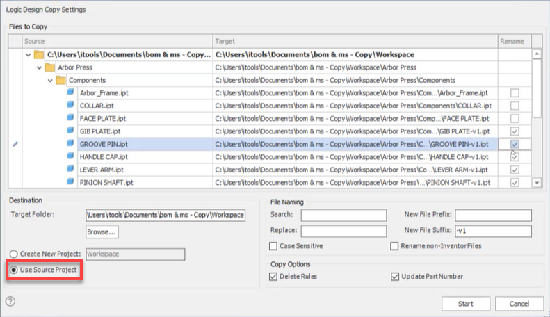

iLogic Enhancements
Reuse files
It is now possible to reuse files without copying them and creating a new project file. If the target folder is the same as the source folder, select the "Use Source Project" option in the iLogic Copy Design Settings dialog and specify the desired prefix or suffix, or the Search and Replace options to rename the files. Then uncheck the Rename option on the specific files that you don't want to rename.
