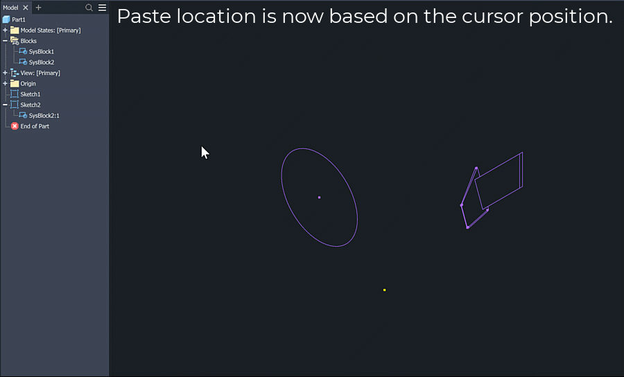

Paste Sketch Geometry uses cursor location
When you copy and past sketch geometry and sketch blocks, the paste location corresponds with the cursor location. The center of the selection set is placed at the cursor location.

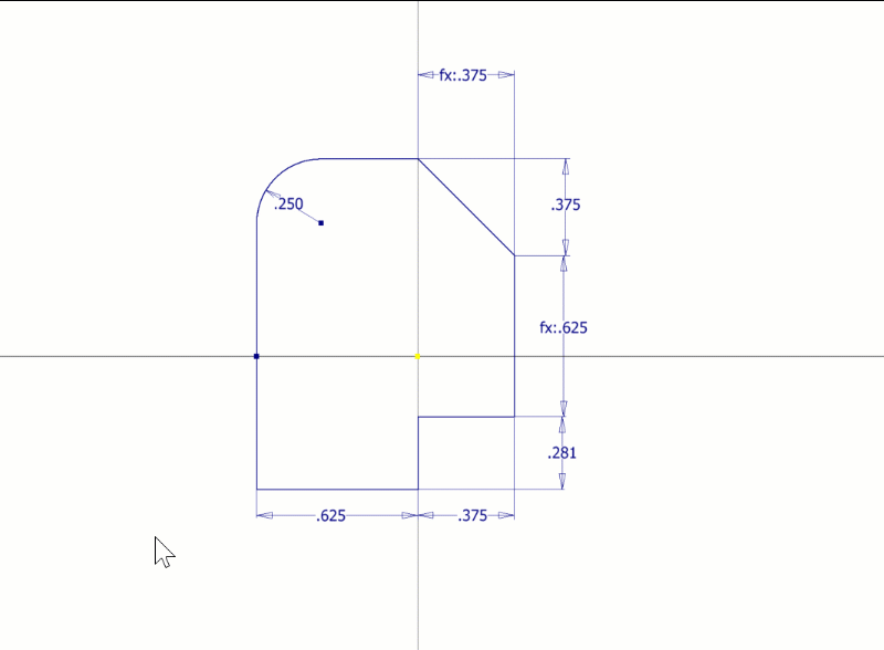

Stabilized Sketch Dimension Placement
Sketch dimensions now remain in their placed positions relative to the geometry they are associated with.
