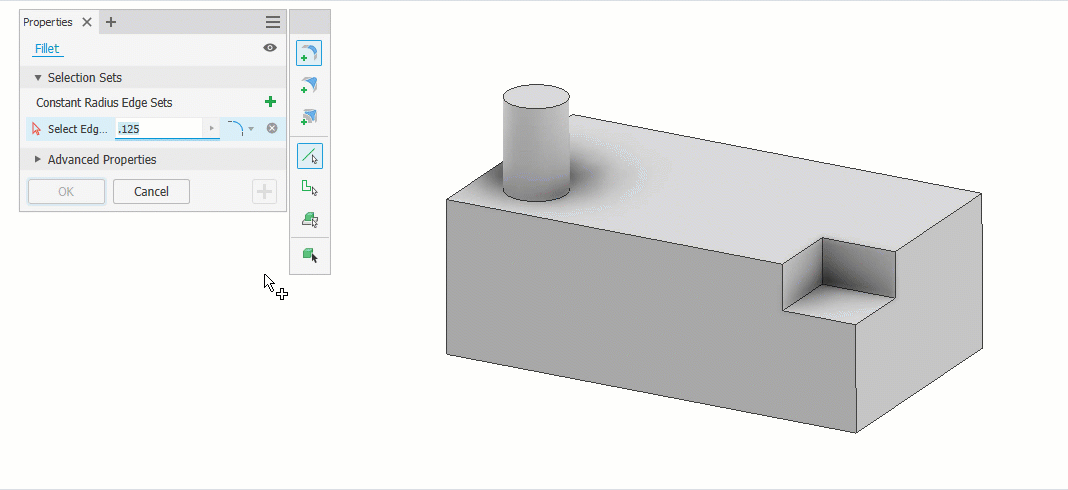

Fillet
For more information, see To Create Edge Fillets.

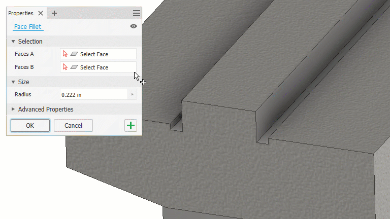

Face Fillet
Adds a fillet feature between two non-adjacent faces of a single solid. If there are contiguous features, these are capped and filled to create the fillet.
For more information, see To Create Face Fillets.

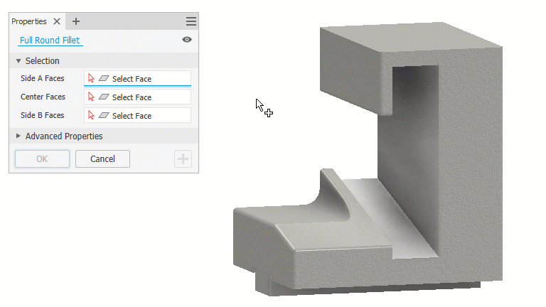

Full Round Fillet
Adds a fillet feature tangent to selected faces or sets of faces.
For more information, see To Create Full Round Fillets.
