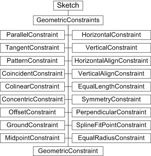

Sketch Constraints Object Model Diagram
Working with sketch constraints through the API
The API has objects for each type of constraint. The GeometricConstraints collection has add methods corresponding to each constraint object type. For example, to create a tangent constraint, call GeometricConstraints.AddTangent. These add methods accept SketchLines, SketchArcs, and SketchPoints as appropriate to their type. For example, a Tangent constraint accepts a SketchLine and SketchArc.

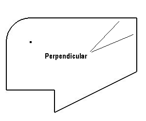

Now add some constraints. First, add a perpendicular constraint between two lines.
Call oSketch.GeometricConstraints.AddPerpendicular(oLine(4), oLine(5))
oApp.ActiveView.Update
The preceding code modifies the appearance of the sketch as follows:

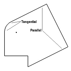

Add tangent constraints to the two lines that join to both ends of the arc.
Call oSketch.GeometricConstraints.AddTangent(oLine(5), oArc)
Call oSketch.GeometricConstraints.AddTangent(oLine(6), oArc)
This has no apparent effect - yet - since the lines and arc are already tangential. To see the effect of the tangent constraints, add a parallel constraint between two lines:
Call oSketch.GeometricConstraints.AddParallel(oLine(3), oLine(5))
The cumulative effect of these tangential and parallel constraints is as follows:

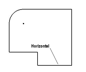

Now constrain the lower angled line to always be horizontal.
Call oSketch.GeometricConstraints.AddHorizontal(oLine(5))
The horizontal constraint results in the following change to the sketch:
