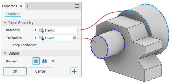

  1. Click 3D Model tab Modify panel Combine .
  2. The Basebody selector is active by default. Select the base solid body in the graphics window. When the selected bodies have different appearances, the Basebody appearance is used for the result of the combine task.
    Note: When a selection is satisfied, a colored dot displays. The dot corresponds to the selection highlight in the graphics display.
  3. The Toolbodies selector activates automatically, select one or more solid bodies to combine with the base. The number of toolbodies displays in the selector. Use window select to expedite selecting multiple bodies.
  4. (Optional) Select Keep Toolbody.
    Keep Toolbody retains the toolbody used in the operation as an independent body. The visibility is turned off after the operation. If not selected, the toolbody is consumed and can’t be used for more operations.
    Tip: Select the Visibility toggle button to keep the toolbody solids visible for the next selection.
    Note: Deleting a Combine command restores the consumed toolbody. The visibility of a retained toolbody is turned off by default.
  5. Choose an Output operation for the combination:
    • Join. Adds the volume of the base and the selected toolbodies together.
    • Cut. Subtracts the volume of the selected toolbodies from the base body.
    • Intersect. Modifies the base solid from the shared volume of the base body and the selected toolbodies.
  6. Click OK or Apply to continue to use the Combine command.
