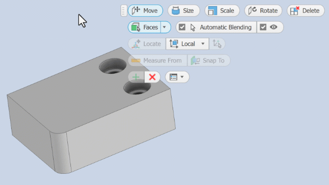

Move or Rotate Faces or Solids Using Direct Edit
Click 3D Model tab
Modify panel
Direct Edit
.In the Direct Edit mini-toolbar, specify the operation you want to perform and the geometry you want to affect:
Move: Activates the triad manipulator for Move operations. Relocates the selection and extends adjacent geometry.
Size: Activates the triad manipulator for changing feature sizes.
Scale: Activates the triad manipulator for scaling operations. Enabled only for solid edits.
Rotate. Activates the triad manipulator for Rotate operations.
Delete: Deletes the selected face and heals the solid.- Faces: Enables faces for selection.
- Solids: Enables solids for selection.
- Automatic Blending: Modifies the total length of a face feature. Automatic blending is a re-blending technology that automatically moves adjacent tangential faces and also creates new blends if required. It is available when you move or rotate a face.
In the graphics window, select the items to move or rotate.
Drag one or more triad handles, enter a parameter name, or enter a precise value for the move distance or rotation angle.
Move manipulators:
Rotate manipulators:
Use the following as needed:
- To relocate the triad, select Locate
. The triad appears on your cursor. Place the triad on the new desired location. - Control the triad orientation with the World and Local options:
- To align the triad to the geometry, first select Local, and then select
on the mini-toolbar. Local places the triad relative to the face or body selected. - To orient the triad with the part origin, select World. With World, the alignment selection is not available.
If desired, select any of the following:
Move
- Measure From. Controls the start location for the distance by selecting existing geometry as a reference. You can measure from most geometry types including sketch and work geometry.
- Snap To. Creates and maintains alignment with other geometry.
Rotate
Snap Parallel. Creates and maintains parallel alignment with another face. This is a planar face selection only.
Note: With Snap To and Snap Parallel, associativity across parts in an assembly is not maintained.
Click Apply in the mini-toolbar.

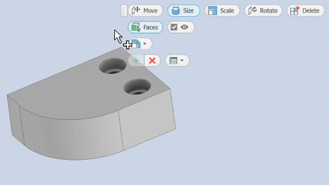

Resizing Faces Using Direct Edit
Click 3D Model tab
Modify panel
Direct Edit
.In the Direct Edit mini-toolbar, select Size.
In the graphics window, select the faces to size.
Note: The parametric hole feature cannot be resized to avoid inaccuracy in drawing files.In the mini-toolbar, select a modifier:
- Offset. Offsets selected faces at a given distance from the selection.
- Diameter. Changes the size of cylindrical faces. Differently-sized cylindrical features are changed to the same diameter.
- Radius. Changes the size of radial faces. Differently-sized radial features are changed to the same radius.
Note: The active modifier controls the faces filtered from the selection set.In the graphics window, drag the manipulator handle and observe the value control for sizing. For explicit control, for example, to change the radius of an object, select the Radius modifier, and enter a value in the input box.
