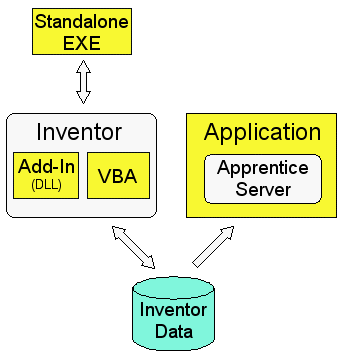

Inventor exposes functionality through its API, and there are different ways to access the API. All of them are useful in certain cases, so it's important to have a basic understanding of the ways to connect to the API so you can make the best decision about how to write your program. The diagram below illustrates the different ways of accessing Inventor's API. A brief overview of each of the methods follows. Detailed information about these is provided in sections devoted to each method: VBA, Add-Ins, and Apprentice Server.
First, a quick explanation of the figure below. The white boxes represent components that provide access to Inventor's API. These are Inventor and Apprentice Server. We'll talk about Apprentice more in a minute. The blue cylinder at the bottom represents the Inventor data you're accessing, i.e. your .ipt and .iam files. All of the yellow boxes represent programs that you write. When one box encloses another box this indicates that the enclosed box is running in the same process as the box enclosing it. For example, VBA runs in the same process as Inventor. An "in-process" program will run faster than a program running out of process.
Types of API implementations
VBA
VBA, or Visual Basic for Applications, is a programming environment that is accessed from within Inventor. Programs written using VBA are frequently referred to as "macros." VBA is typically used by end-users to write small programs to automate repetitive tasks, although it is certainly not limited to this. A VBA program has the same access to all of the features of the API as any of the other methods of accessing the API (with the exception of Add-Ins, which we'll discuss later).
When deciding which method to use when programming Inventor, there are a few advantages to consider when using VBA. First, VBA is delivered with Inventor and does not require you to purchase an additional programming language. Second, you are able to embed programs within Inventor documents. If you have a program that is data-specific, this is a convenient way to keep the program with the data it is designed to use. (You're not forced to save your programs in Inventor documents. You can also save programs in separate files so they can be shared among users and documents.) Third, VBA runs in the same process as Inventor so you gain the performance advantages of being in the same process. Fourth, VBA was designed to work with Automation types of API's and is the most user-friendly environment for learning Inventor's API.
Add-Ins
Add-Ins are a special type of Inventor program. An Add-In is able to do one thing that none of the other methods of accessing the API is able to do; Inventor starts the Add-In automatically whenever Inventor is run. This has a huge advantage in that the add-in is able to insert itself into Inventor's user-interface and connect to events to be able to watch for and respond to activity within Inventor. This allows add-in functionality to appear the same as built-in Inventor functionality. Add-ins also have a distinct advantage over VBA in delivering your program to users and managing your source code.
Add-Ins can be written using any language that supports the creation of ActiveX DLLs, such as Visual Basic, C#, and Visual C++. Add-Ins cannot be created with VBA.
Standalone EXE
A standalone EXE is a program that runs on its own and connects to Inventor. This type of program is typically used in the case where you have a program that has its own interface and doesn't require the user to interactively work with Inventor. For example a batch plotting utility can be an EXE that runs independently of Inventor. It might monitor a database watching for new records to be added which describe documents that need to be plotted. When a new record is created in the database, the standalone EXE starts Inventor, if it's not already running, opens the desired document and plots it, all without any user interaction.
Standalone EXEs run out-of-process to Inventor, so there is some performance penalty, but since they are not usually used for interactive processes it's rarely an issue. Even in the case where performance is an issue it's possible to combine the use of an add-in and an exe. You can have an add-in that does the majority of the work and an exe that calls the add-in.
You also run in a standalone EXE mode when you write programs within another application's VBA. For example, if you write a program using Excel's VBA that connects to Inventor, your VBA program is running in the process space of Excel and is communicating with Inventor out of process.
Apprentice Server
Apprentice is an ActiveX server that can be used by other applications to get access to Inventor data. Apprentice is essentially a subset of Inventor that runs in-process to the application using it. Apprentice doesn't have a user interface and the only way to interact with it is through its API. Apprentice provides access to a limited set of full Inventor functionality with the primary areas being assembly structure, B-Rep, geometry, and iProperties. Most access to information through Apprentice is read-only; (a couple of exceptions to this are iProperties and file references).
Apprentice is useful in any standalone application that needs access to information contained within Inventor documents. The alternative is to use Inventor. Using Apprentice is much more efficient than using Inventor to perform the same operations because Apprentice is able to run in the same process as your application and because it doesn't have a user interface it can perform many operations faster.
Another advantage of Apprentice Server is that it's available at no cost and is available on the public Autodesk website as a standalone application by searching it from the website. More detailed information about Apprentice can be found in the Apprentice Server section.

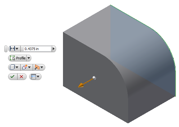

The objects exposed by Inventor’s programming interface represent the things in Inventor that you're already familiar with. For example, look at the extrude feature shown below. For each extrude feature that you create in a part, there is an ExtrudeFeature programming object that represents it. The ExtrudeFeature object supports various properties and methods that allow you to query and edit the extrusion. These properties and methods provide equivalent functionality to what you specify when creating and editing an extrude feature the user interface. For example, the ExtrudeFeature object supports the Name property. This is the name of the feature that is displayed in the object browser. You can get the value of this property to see the current name of the feature and you can set the value of this property to change the name of the feature. The ExtrudeFeature object also supports the properties ExtentType, Operation, Profile, and others. The ExtentType property specifies that this is a distance extent. The Operation specifies that this is a "new solid" operation. The Profile returns the sketch information that defines the shape of the feature. These are the API equivalent of the options provided in the mini dialog shown below.
Extrude Object
An important point to emphasize here is that most of the API is just another way besides the user-interface, of accessing Inventor’s functionality. Because the API allows you to do the same things you can do through the user-interface there are strong similarities between the two. Having a good understanding of Inventor from the standpoint of an end-user will make the API easier to understand and use.

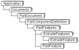

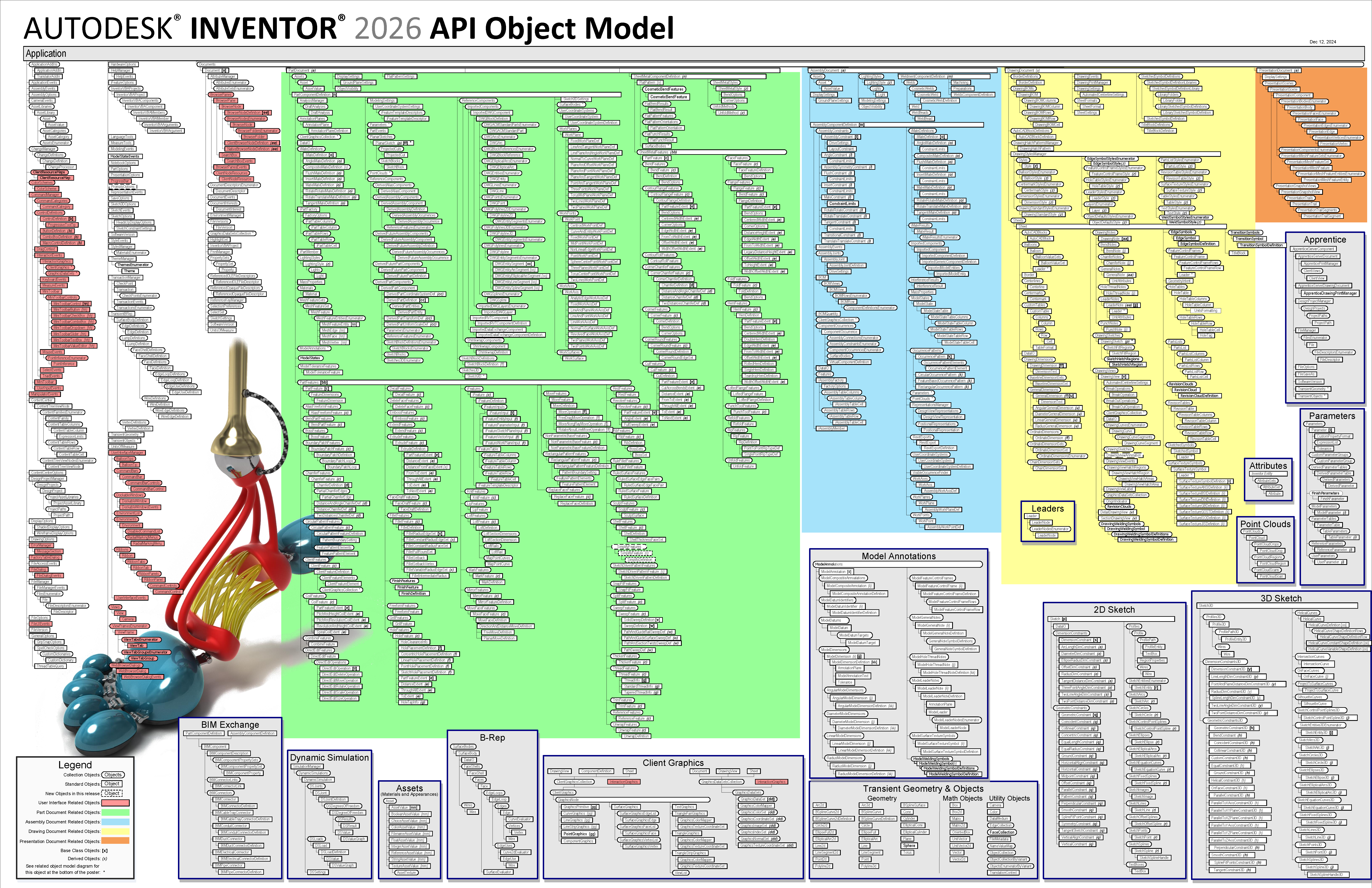

The object model is a hierarchical diagram that illustrates the relationships between objects. One of the most important objects in this hierarchy is the Application object. The Application object represents the Inventor application and is the top-most object in the hierarchy. The Application object supports methods and properties that let you control Inventor but most important, it supports properties that return other Inventor objects. Because of this, once you have the Application object you can access any other object in the hiearchy. The object model picture is useful as a tool because it illustrates how to get from one object to another. You just need to understand how to traverse the hierarchy to get to the specific object you want. The diagram below illustrates the portion of the object model that is needed to access the part extrude feature, (ExtrudeFeature object).
Extrude Object Hierarchy
The code below illustrates using the relationships indicated in the object model diagram above to access the extrude feature named “Extrusion1”.

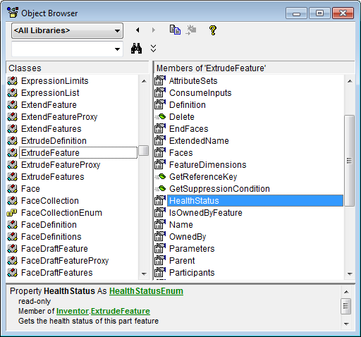

Object Browser
This is a tool you'll want to take advantage of when working with Inventor’s API. You access it from the VBA programming environment by pressing the F2 key, the toolbar button Object Browser Button, or selecting Object Browser from the View menu. The Object Browser is shown below.
The left column of the browser, titled “Classes”, contains a list of all the objects available in the libraries currently attached. In the drop-down list at the top-left of the browser, “” in the example above, you can specify a specific library to limit the list to only the objects in that library. In this example, the ExtrudeFeature class has been selected.
The right column displays a list of the methods, properties, and events supported by the selected class. Selecting one of these will display information about that function at the bottom of the object browser. In the example above the HealthStatus property has been selected. At the bottom of the dialog we learn that this property returns a HealthStatusEnum value. (Enum values are lists of values that are also defined in Inventor’s type library.) We also learn that this property is read-only, meaning that we can get the value but we can’t change it. A brief description of the selected function is also displayed at the bottom of the browser. The online help is useful in conjunction with the browser because it is context sensitive. Pressing F1 at this point will bring up the help page for the HealthStatus property.

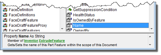

Here are more examples of the information that’s displayed at the bottom of the object browser and how to interpret this information. In the example below, the Name property of the ExtrudeFeature object is selected. The property returns a String. Notice that unlike the previous example, it does not say that it is read-only so this property is read-write. Using this property you can get the name of the feature and you can also assign a String to this property to set the name of the feature.

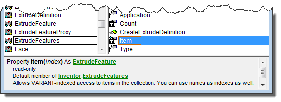

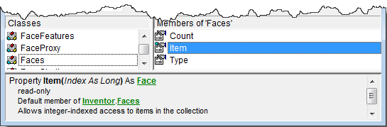

The Item property of a collection object was discussed earlier. Remember that you can always use a value as the index to get a specific item and sometimes you can also use the name of the item. The two examples below show one technique to determine if using a name is supported. The first example is for the ExtrudeFeatures collection. It shows that the Item property has one argument called index. Notice that it doesn’t say what type this argument is. Whenever the type is not specified that means it is a Variant. A Variant is a special type that can represent any variable type. In this case index is a Variant to allow you to provide either a Long or a String. Often, as in this case, this is also indicated in the description and in the online help. In the second example, index is specified to be a Long value. In this case you can only supply a value. Supplying a String will cause a failure.
Item Example
Item Example

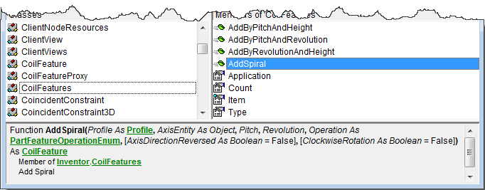

Here's a more complicated signature and more about what can be learned by looking at the signature in the object browser. We’ll use the AddSpiral method of the CoilFeatures collection object. This method has several arguments. The first is called Profile and requires a Profile object as input. The second called AxisEntity doesn't have a specific type but will take any object. What this means is that this particular method will take more than one type of object for this argument so a specific type can't be specified. In this example it can be a sketch line or work axis. The Pitch argument does not have a type displayed because it is a Variant. In this case you can use either a Double specifying the pitch in centimeters or you can use a String and specify an equation which can include parameter values. The same is true for the Revolution argument; it can be a Double or a String. The Operation argument expect a value from an enum list. The last two arguments are optional. In this case they both happen to be Boolean arguments and both default to False if not provided. For more details about all functions and their arguments you can use the API help. You can easily access the help for a particular object or function by pressing F1 when using the object browser.
Add Spiral

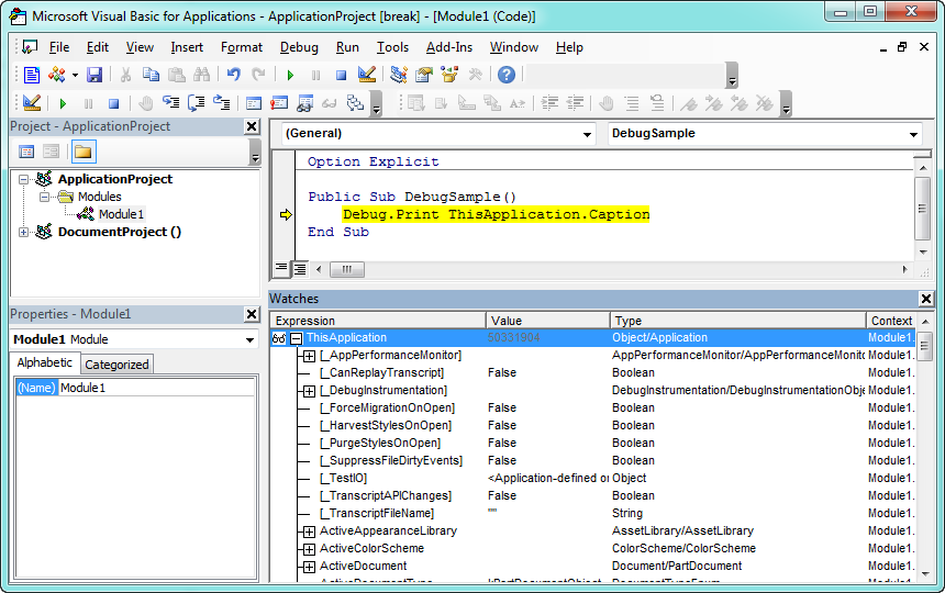

Using the VBA Debugger
Another very useful tool when working with Inventor’s API is the VBA debugger. In this case we’re not using it to debug a program but using some features of the debugger to better understand Inventor’s object model. To use the debugger we need to be running a program. Fortunately we don’t need much of a program to enable access to the Inventor objects. The specific steps to use the debugger are listed below.
  1. Within any code module, create a sub, like the sub Test shown below.
  2. Click the mouse anywhere within the sub and press F8 to step into the code. You’re now running the sub one line at a time.
  3. Click anywhere within the word “ThisApplication”.
  4. Run the Quick Watch command from the Debug menu and click “Add” in the Quick Watch dialog.
  5. The debug window will appear and ThisApplication will appear within the debug window. This represents a live view of the Inventor Application object. You can click on the “+” sign next to ThisApplication to expand it and view its properties and their values. Properties that return other objects will also have the “+” sign next to them allowing you to continue to expand the objects and view their properties. This provides a live view of the object model.
    VBA Debug
