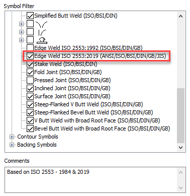

Edge Weld Symbols now uses the latest available ISO 2553-2019 standard. The symbol is added to the Style Editor and enabled by default for the following standards: ISO, DIN, ANSI, BSI, GB, JIS, GOST (only in weldment).
A Stake Weld per EN ISO 2553:2017 is added. The symbol is added to the Style Editor and enabled by default for the following standards: ISO, BSI, DIN, GOST (only in weldment). It is also available for the following standards but not enabled by default: ANSI, JIS, GB, GOST (only in drawing).

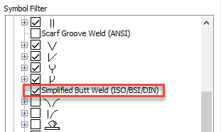

Simplified Butt Weld and Edge Weld Symbols now uses the latest available ISO 2553-2019 standard. The symbol is added to the Style Editor and enabled by default for the following standards: ISO, BSI, DIN, GOST (only in weldment). It is also available for the following standards but not enabled by default: ANSI, JIS, GB.

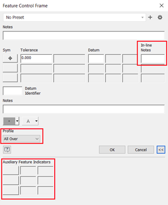

It is now possible to add the "All Over" symbol on the Feature Control Frame. Use the new "All Over" option in the Profile drop-down menu in the Feature Control Frame dialog.

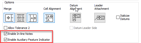

You are also able to enter prefix , suffix and auxiliary feature indicators per ISO 5458 & 5459 standards in the Feature Control Frame dialog. First, enable the options using the new check boxes added to the Style and Standard Editor dialog. Also note that the cells become enabled as you fill the cells in.
This enhancement is added for an ISO and ISO based standards, and it is enabled by default. For other standards such as ANSI or ASME it is disabled by default in the Styles Editor.
Additional identifiers were added to the Feature Control Frame style dialog to comply with ISO 5458, ISO 14405-1:2016, and ISO 1101 standards.
For more information see Style and Standard Editor - Feature Control Frame Style Reference.
