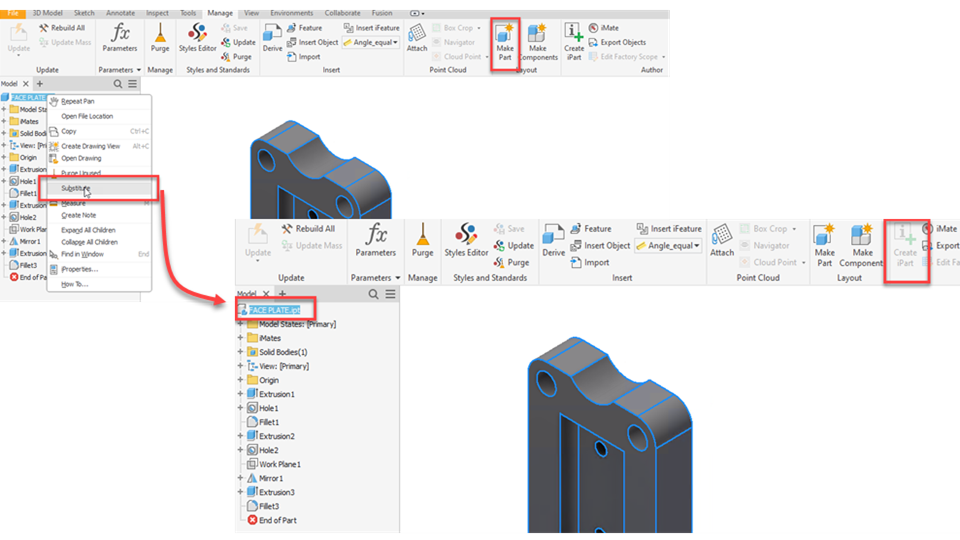

Model State Enhancement
Use the "Substitute" option from the content menu in the Part Browser node. The Part Browser node reflects the status of the substitute part, and the "Create iPart" command is disabled.
