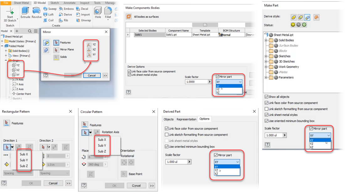

Origin Work Features
Custom names assigned to Origin work features are now recognized and populate the various dialogs such as Mirror, Make Components, Make Part, Rectangular and Circular Pattern, and Derived Part.

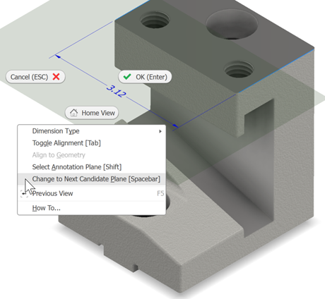

3D Annotations or Model Based Dimensioning
During forward creation of 3D annotations (3DA), the right-click menu option to change the annotation plane has been renamed from Select Next Candidate Plane to Change to Next Candidate Plane.
For more information see To Work with General Annotations.

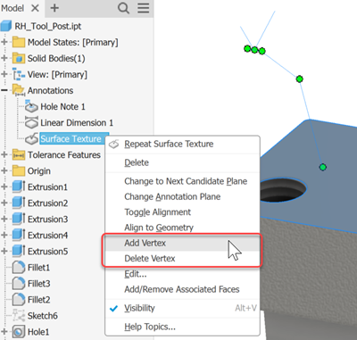

Context Menu items moved
When editing a 3DA annotation that has a leader, you can right-click and choose Add Vertex or Delete Vertex to modify how the leader looks. With this release, the position of those two commands has moved within the context menu.
For more information see To Work with Text and Leaders.

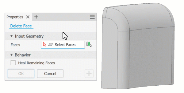

Delete Face
The Heal Remaining Faces option last use state is now remembered, even if the dialog is cancelled. Select it once and from that point on, it is remembered. The default setting is deselected.
For more information see Delete Face.

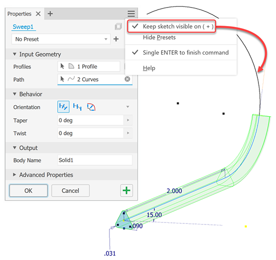

Sweep enhancement
When using the Sweep command, you have the option to keep the path sketch visible when using Apply to create a sweep segment. In the Sweep property panel, in the advanced settings menu, select the option to Keep sketch visible on ( + ).
For more information about sweep features see To Create Sweeps.
For more information about property panels see About Property Panels.

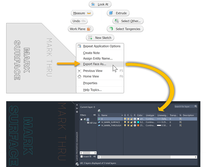

Mark Feature Export
When using the Export Face As command to export faces with mark features to DXF, the Mark Style layer settings are preserved in the DXF file.
For more information see About Export of Faces and Sheet Metal Flat Patterns.

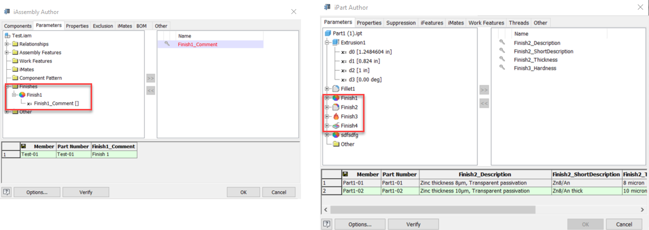

Export All Parameters
It is now easier to select all finish parameters at once for export. Export all Finish Parameters check box is added to the Advanced Properties section of the property panel. When selected, all finish parameters are automatically selected for export to Custom iProperties.
iComponent Support
The Finish feature parameters can now be captured in an iPart and/or an iAssembly using the authoring workflows.
